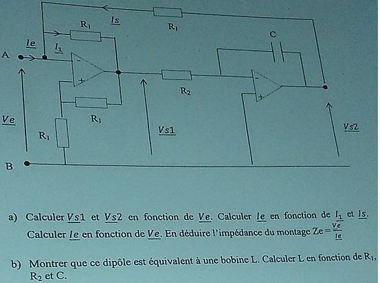

Good morning everybody,I'm french and my english isn't good but I need help for this exercice please:
I tried to do this exercice,however I'm not sure of my answers,can you tell me if they are good , or what mistakes I committed ?
Here the exercice :
2. Revelant equations
The questions are:
a)Calculate Vs1 and Vs2 according to Ve
Calculate Ie according to Is and I1.
Calculate Ie according to Ve.
b) Show that this dipole is equivalent to a coil L,calculate L according R1,R2,and C.
Deduce the impedance of the assembly(mounting)
3. The Attempt at a Solution

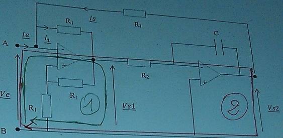

And here is what I have said:
Question a)We use the mesh(or stitch) 1 so Ve-Vs1=
Ve-Z1.ie=0=>Ve=Z1.ie= (R1+R1).ie=2R1.ie(the resistors are in series).
Then for the mesh(or stitch) 2,on a Ve=Z2.ie=R2.ie.
Then to express ie depending on I1 and Is, it can be said according to the law for the nodes ie=i1+is.
After we know that Ze.ie=Ve ,so ,ie=Ve/Ze that's why Ze=Ve/ie=2R1.
b) I don't know
From your second attached figure, it seems that you try to solve the problem by means of KVL. Instead I would suggest that you regard the circuit as a closed loop, included two inner loops, namely the left amplifier circuit ( A1+R1+R1+R1 ) and the right amplifier circuit ( R2+C+A2 ).
The outer loop has a feed back ( Is ) through the upmost R1 ( current feedback ).
As for the inner loops, you must calculate/setup transfer functions. The rightmost is the most easy, so I will choose that to show you what I mean :smile:
( I hope you know about Laplace transforms, Laplace was from France, I think ):
The sum of currents into A2inp- = 0 →
Vs1/R2 + Vs2*sC = 0 →
Vs1/Vs2 = -R2⋅Cs →
Vs2/Vs1 = -1/(R2⋅C)s
So you simply sketch this rightmost transfer function as a "block" inside the outer loop.
Likewise you sketch the transfer function for the leftmost inner block. You should ( by intuition ) see that
Vs1/Ve = 2
because otherwise the amplifier circuit will not be "in balance". ( A1inp- = A1inp+ ).
Having sketched the outer loop, apply "Masons rule" to calculate the transfer function, and calculate
Ve/Ie
which is the input impedance of the circuit, and it should be possible to write it in the form:
Ve/Ie = sL
which is the answer to:

Thank you for your help,yes Laplace was from France effectively.
I will review my course to completely understand what you say,but I have a question,what does mean "inp-" and what it is "s"?
For example the integrated amplifier, A1 ( leftmost ), has one output, and two inputs ( a negative and a positive ). I have just named the negative input A1inp- , and thus the positive input A1inp+ .
"s" is a complex variabel, used in the Laplacian domain, like "t" in the time domain.
For example you can describe a sinusoidal signal in the time domain by: F(t) = V*sin ωt.
The Laplace transform of this signal will be: F(s) = V*ω / ( s2 + ω2 ).
Now, if you want to determine dF(t)/dt, you do this in the Laplace domain by multiplying F(s) by s, so
s*F(s) = V*ω*s / ( s2 + ω2 )
which is the Laplace transform of G(t) = V*ω*cos ωt.
In the frequency domain, the impedance of a capacitor is described by: Zc(ω) = 1 / jωC.
In the Laplacian domain it is described by: Zc(s) = 1 / sC.
L(dF(t)/dt) = s*F(s)
L( ∫(F(t)⋅dt ) = F(s) / s
That's the clever thing about Laplace transforms. It is very comfortable to do calculations by Laplace. You will see that when you review your course.
