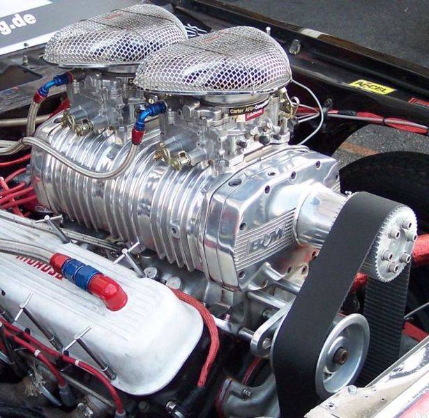

Ranger Mike said:
... gilmer belt drive cuts harmonics, takes minimum horsepower maximum durability.
And, for you younger guys (lol) that don't know what a Gilmer Belt is...
