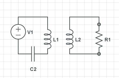

In the given picture, I need to formulate some kind of solution to find functions for the current, knowing that the two inductances create a mutual inductance (coupling)
I start by formulating these two equations where M is the mutual inductance.
For the left, E= Q/C + L1*dI1/dt - M*dI2/dt
and
for the right, 0= L2*dI2/dt + R*I2 - M*dI1/dt
Does this look okay so far, and where should I go from here?

What is Q?. Find it and the question will be solved.
Q is just the charge on the capacitor
Is there a relation between Q and I1, I2 ?
I'm sure there is one, but Q is just a characteristic of the capacitor.
The two equations you have made have 3 variables(Q ,I1, I2,) so it can't be solved. Try to get a third equation and you will have 3 equations for three variables.
Hint: The third equation is a relation between I1 and Q. What is it?
