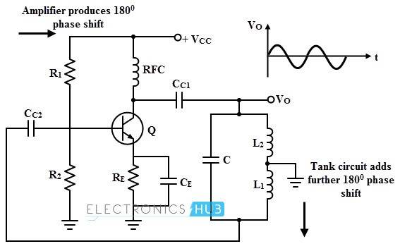

Hi,
I'm watching a video about Hartley oscillator and I'm in trouble with a simple assumption: as stated at minute 5:50 if the two coils ##L_1## and ##L_2## are wound on the same core then taking into account the mutual inductance M he gets:
##L^ {'} _1 = L_1 + M##
##L^ {'} _2 = L_2 + M##
From my understanding it surely makes sense if we assume equals the currents through the two coils ##I_{L_1} = I_{L_2} = I##.
However I believe they are not the same from the analysis of the small signal equivalent circuit at least when we do *not neglect* the BJT input impedance ##h_{ie}##.
One capacitor is connected between the ends of the inductors, so the currents will be equal if the capacitor current dominates the inductors. That will be the case with a high Q oscillator circuit.

In principle, there are two basic explanations how the Hartley oscillator works.
(1) The first one - as discussed already - starts with an LC tank circuit which (due to the grounded midpoint of the coil) provides (at resonance) a 180deg phase shift at both ends .
(2) Second explanation: The feedback path consists of a 4th-order highpass (C2-L2-C-L1) in ladder topology which - at one single frequency - also can provide a 180deg phase shift.

Referring to the schematic in post #6, does the 4th-order highpass filter consist of Cc1-L2-C-L1 ?
There are several ways of drawing a Hartley oscillator. The usual way I have seen is given like this and is a very convenient arrangement because no RFC is required, one side of the tuning capacitor is grounded (avoiding hand-capacitance) and no RFC is required. Of course, bias and decoupling components will be required but their reactance should be negligible. It is not usual to employ these components as part of the LC network, to create a ladder network for instance.
In the configuration shown there are only two frequency determining components. I think the distinction from the Colpitts circuit is that the latter uses a capacitive tap. A capacitive tap is equivalent to a resonant transfomer, where the turns ratio corresponds to the capacitor ratio. The transformer shown is resonated by C so that we do not have to worry about leakage inductance, which is tuned out. If we use separate inductors, then it is exactly equivalent to the Colpitts circuit but with XL instead of XC. The circuit shown is using coupled windings, acting as an auto transformer, so the ratio is of the form N1/(N1 + N2).
When we use a tuned transformer between a source and a load, the circulating current is large due to the resonant action. But at the connections to the outside world, relatively small resistive currents are flowing. In general they are not equal because source and load may have different resistances, and so the total currents in the two coils may differ slightly.
You can visualise the circuit with no C and just an iron cored transformer, where audio oscillation will occur. 180 degrees phase shift occurs due to the connection sense of the windings and another 180 degrees due to the transistor.
Yes, of course...see my post #5.
By the way - in general, all known oscillator circuits have a frequency-selective feedback path (lowpass, highpass, bandpass).
