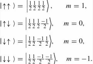

Can't understand ket notation for spin 1/2

Each particle can have spin up or spin down, so there are four possibilities.
It's from Example 4.5, from Griffiths (Quantum Mechanics)
I can't why there are four elements in each ket instead of only two
Four equations expressing two-spin-1/2 product kets as tensor products of single-particle spin states, with m values 1, 0, 0 and -1: |↑↑> = |1/2 1/2 1/2 1/2>, m = 1; |↑↓> = |1/2 1/2 1/2 -1/2>, m = 0; |↓↑> = |1/2 1/2 -1/2 1/2>, m = 0; |↓↓> = |1/2 1/2 -1/2 -1/2>, m = -1.

I can't why there are four elements in each ket instead of only two View attachment 279407
The notation is that the first two 1/2 just indicated the spin of each particle. The last two entries give the z component of the spin, ##S_z## of each particle.

With electrons it is understood that the spin is 1/2 and is often omitted for compactness. In that case instead of ##|\frac{1}{2},\frac{1}{2},s_{1z},s_{2z}\rangle## one can write ##|s_{1z},s_{2z}\rangle## where ##s_{1z},s_{2z}=\pm \frac{1}{2}## or use ##\uparrow\downarrow## as Griffiths does.
If the two spins, or more generally angular momenta, are greater than 1/2, one must be clear about what one means and write the full-blown ##|S_1,S_2,S_{1z},S_{2z}\rangle## to avoid confusion.

Thanks! I see it now!
In the later edition he abandons that notation, in fact. Instead, he has:
$$\uparrow \downarrow \ = \ |\frac 1 2 \frac 1 2 \rangle |\frac 1 2 -\frac 1 2 \rangle $$
