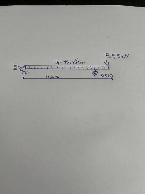

Cantilevered and line-loaded, steel cross section. IPE profile. Dimension the steel cross section and control stresses. Material properties. Fm 355N/mm2, fv = 204n/mm2, E = 210 000 N/mm2 Cross section not known. Length of beam 5 m, point load across beam 12kNm, point load 25 kn. Beam left to right 4, 5 m, right to left 0,5 m is point loaded
I found the internal force Vxy 25 +6 =31kn. , bending moment Mmin -qb2/2 , M min- 14 kNm. delta =M/W I can't find Mmax and tau= V/As. So I need help to find Mmax and As wall area, how to find.

Could you show us a diagram of the beam and loads distribution?
That's very hard to read, and mostly blank space. Please post a better shot.

5x12=6?
I think you are misinterpreting " load across beam 12kNm".
The units kNm make no sense, so I read this as a distributed load of 12kN/m, for a total 5m x 12kN/m = 60kN.

Yes, the load over the beam is 5 x 12 =60 kN, and the point load on the right 25kN . The total vertical force is 85 kN. I need to find Vxy ?
vertical axis of the cantilever beam
Mzmin= − q(b) squared divided by 2.
M z min is the minimum bending moment,
q is the magnitude of the distributed load (linear load),
b is the beam height.

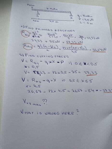

I'm trying to solve it step by step and figure it out.

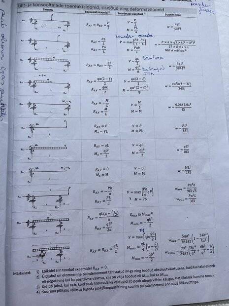

I attach a table of the formulae that are required to solve.
Something is still wrong
That table is a dreadful way to solve such problems. Far better to understand the principles. But that does require some basic calculus.
Do you understand how I did it post #14?
I tried to understand, but since I have to keep track of the formulas, it gets confusing.
We would only be required to work with the formulas.

Since the formulas cannot cover every case specifically, you need some rules on how to combine the formulas in any given case.
Can you see two examples in the table which, in some sense, should add up to the case in this thread?
yes, with the help of these ready-made helpers I will try to solve it.
ok, but I really do not see how those cases can tell you what the minimum and maximum torque are.
