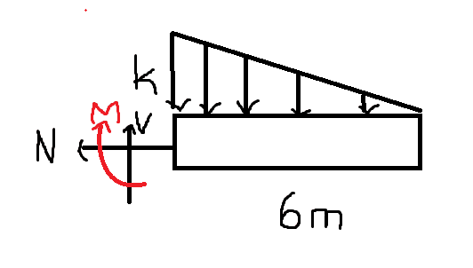

Determine the resultant internal loadings acting on the cross section
at C of the cantilevered beam
http://imgur.com/Q4ZUTOq
1. Homework Statement
F = 270 N/m
ΣV = 0
ΣM = 0
ΣN = 0
section CB[/B]
k/6 = 270/9
k = 180 N/m
resultant force = area under the curve = 1/2 * 180 * 6 = 540 N
ΣN = 0
-N = 0
N = 0
ΣV = 0
V - resultant = 0
v = resultant = 540 N
How can i find M ?

You can calculate the shear force diagram for this beam given the loading as shown.
What's the relationship between the bending moment and the shear force?
You have already determined the resultant force of the load . At what point does it act? Then sum moments and watch directions.

At the free end of the cantilever, M = 0. What must M be at point C for that segment of the beam to remain in equilibrium?

The only problem is, M can't be zero at point C, 'cuz of that applied force. What's the moment due to the applied force?
if the beam is uniform then cg will be length / 2 = 6/2 = 3m from C
in your diagram, the loading on the beam is not uniform; it is triangular. The centroid of a triangle is not at its center.

centroid of triangle is 1/3 * 6 = 2

How do you use the centroid of the applied load to calculate the moment due to that load?
Yes , 2 m from where? Now place the resultant force at that point and sum moments about the left end of your section to find the internal moment at that end.
total force times the distance from centroid to C
2m from zero reference point means from the left of the beam.
so moment = [itex]force * distance = 540 *2 = 1080 Nm[/itex]
[itex]ΣM = 0[/itex]
[itex]M + 1080 Nm = 0[/itex]
[itex]M = -1080 Nm[/itex]

Yes, but can you explain the meaning of the minus sign in front of your answer?
M is anti - clockwise
