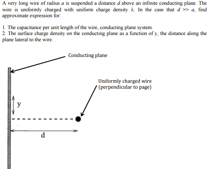

I want to know whether my process is correct?

1. By using Gauss's law:
E\cdot 2\pi rz = \frac{\lambda z}{\epsilon_{0}}\Rightarrow E=\frac{\lambda}{2\pi\epsilon_{0} r}
In my coordinate system, E=\frac{\lambda}{2\pi\epsilon_{0}[y^{2}+(z-d)^{2}]^{-1/2}}
Then,
V=-\int\mathbf{E}\cdot d\mathbf{l}=-\int_{0}^{z}\frac{\lambda}{2\pi\epsilon_{0}[y^{2}+(z-d)^{2}]^{-1/2}}dz=\frac{\lambda}{2\pi\epsilon_{0}y}\ln{\frac{\left | \sqrt{d^{2}+y^{2}}-d \right |}{\left | \sqrt{(z-d)^{2}+y^{2}}+(z-d) \right |}}
Since C=\frac{Q}{V}, then
<br /> C(\text{per length})=2\pi\epsilon_{0}y\ln{\frac{\left | \sqrt{(z-d)^{2}+y^{2}}+(z-d) \right |}{\left | \sqrt{d^{2}+y^{2}}-d \right |}}<br />
2.
Use \sigma=-\epsilon\frac{\partial V}{\partial z}|_{z=0} to get the answer.
No, several errors.
You have written the expression for the field at some arbitrary point, (y, z).
First problem: the expression would be correct without the plate. Perhaps the charge distribution on the plate changes it?
Second problem: you integrate this wrt z,but leaving y as arbitrary. What path is that along?
Note that it would be simpler to run the integral in the other direction, avoiding the d-z.
Third problem: if you fix the second problem, you will get an integral that diverges at the wire end. You need to take into account the radius of the wire.
Fourth problem. You have z as a bound on the integral. What should it be?

Now, I correct my process!
Firstly, the electric field generated by the plane is E_{plane}=\frac{\sigma}{2\epsilon_{0}}\hat{\mathbf{z}}.
Then, by the definition of potential, I can get the potential V_{plane}=-\frac{\sigma}{2\epsilon_{0}}z
On the other hand, the electric field generated by the wire is E_{wire}=\frac{\lambda}{2\pi\epsilon_{0}r}\hat{\mathbf{r}}
Then, the potential is V_{wire}=-\frac{\lambda}{2\pi\epsilon_{0}}\ln{\frac{r}{a}}=-\frac{\lambda}{2\pi\epsilon_{0}}\ln{\frac{\sqrt{(z-d)^{2}+y^{2}}}{a}}
Thus, the total potential will be V_{total}=-\frac{\sigma}{2\epsilon_{0}}z-\frac{\lambda}{2\pi\epsilon_{0}}\ln{\frac{\sqrt{(z-d)^{2}+y^{2}}}{a}}
Now, we can use the relation \sigma=-\epsilon\frac{\partial V}{\partial z}|_{z=0} to get the surface charge density.
<br /> <br /> \sigma = \frac{\lambda}{2\pi} \frac{a}{\sqrt{(z-d)^{2}+y^{2}}} \frac{1}{2} \frac{2(z-d)}{\sqrt{(z-d)^{2}+y^{2}}} |_{z=0} + \frac{\sigma}{2}\\<br /> \frac{\sigma}{2} = \frac{\lambda}{2\pi} \frac{-ad}{d^{2}+y^{2}}\\<br /> \sigma = \frac{-\lambda a d}{\pi(d^{2}+y^{2})}<br /> <br />
That expression is for a uniformly charged plane. It won't be.
Consider the method of images.
At first glance of the question, I came up with this method.
However, the plane isn't grounded so I am unsure if this method is valid for this problem?
It is an infinite plane. That is effectively grounded.
Likes Kelly Lin
Oh~ I see~
Thanks a lot!
