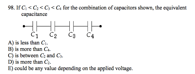

Capacitance -- combining multiple capacitors for equivalent C
In the given problem, Ceq = C1C2C3C4/(C1 + C2 + C3 + C4)
The answer says the equivalent capacitance is always less than C1 but I can't come up with thy. When I do this, I can't seem to prove that equivalent capacitance is always less than C1. For example, if I let:
C1 = 998 F, C2 = 999 F, C3 = 1000 F and C4 = 10001 F, then I get an answer (767119326 F) and this is much larger than C1. Any suggestions?
(I realize the capacitances used here are very large, but they are just used to make a point.)

Use Q=CV and discover that now four capacitors have to share the voltage that C1 would have had all on its own if C2,3,4 were absent!
Perhaps your formula is questionable ?
When I do
$$ {1\over C_{eq}} = {1\over C_1} + {1\over C_2} + {1\over C_3} + {1\over C_4} $$
I get something completely different ! Which has the right dimension. Your ##C_{eq}## does not have the dimension of Farads ...
Hint: The ##C_1 C_2 C_3 C_4## in the numerator is correct.

Well I know:
Ceq = Q(V1 + V2 + V3 + V4)/(V1V2V3V4)
I just don't quite see how this shows Ceq < C1...do you mind explaining further?
You know this for two capacitors, because then it comes out right.
What you wrote here has the dimension Coulombs * Volts / Volts4 and that is not Farads ...
So: from where did you get this ?
You mean you know that
$$ {1\over C_{eq}} = {V\over Q} = {V_1\over Q}+{V_2\over Q}+{V_3\over Q}+{V_4\over Q} $$

Ceq = Q/(V1 + V2 + V3 + V4)
Also, Veq = V1 + V2 + V3 + V4
So since C1 = Q/V1 then Ceq must be smaller (i.e. it is divided by more positive numbers).
Thank you!
Just in case you ever need to calculate the ##C_{eq}## for 4 capacitors in series: do you know how to work out
to ## { C_{eq}} = {C_1 C_2 C_3 C_4 \over ?} ## ? And: can you guess why anyone would ever use capacitors in series in a circuit ?
