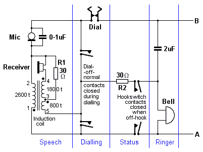

Here's a diagram of an old phone. Both capacitors would be non-polarized types, so do not deteriorate much with age. I don't think capacitors themselves have much in the way of inner workings - just rolls of metal foil separated with plastic film.
If you have an old phone, you don't need to worry about charging. They get their power from the phone line.
