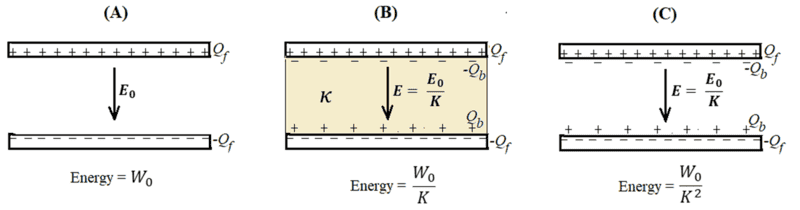

Consider these diagrams which show the same parallel plates under different conditions.
In diagram (A) there is no dielectric and the plates are given free charge ##\pm Q_f##.
In diagram (B) there is a dielectric material between the plates with dielectric constant ##K##. The plates are charged with the same free charge ##\pm Q_f## as in (A). Polarization of the dielectric material will cause some bound charge ##\mp Q_b## to appear on its upper and lower surfaces as shown.
In diagram (C) there is no dielectric. The plates have again been given the same free charge ##\pm Q_f## as in (A) and (B). In addition, charge ##\pm Q_b## has somehow been “stuck” to the inner surfaces of the plates as shown. ##Q_b## in (C) is selected to be the same as in (B). So the distribution of free and bound charge is the same in (B) and (C).
The electric field ##E## between the plates is indicated in each diagram. (B) and (C) have the same field, which is less than the field in (A) by a factor ##1/K##.
The energy stored in the system in each case is shown. I let ##W_0## represent the energy stored in (A). The energy ##W_0## is the work required by an external agent to bring the free charge ##\pm Q_f## bit by bit from infinity and add it to the plates. (Or, if you prefer, the external agent could transfer ##Q_f## from the lower plate to the upper plate. I will think of the agent as bringing in charge from infinity.)
The energy stored in (B) is less than (A) by a factor ##1/K##. So, the external agent does less work in bringing in ##\pm Q_f## in (B) than in (A). Note that the agent does not need to bring in the bound charge. The bound charge appears “on its own” due to polarization of the dielectric. Nevertheless, as the agent brings in bits of free charge, the work required is affected by the presence of the bound charge. So, the total work to bring in ##\pm Q_f## is different for (A) and (B).
The energy is least in scenario (C). In this case the external agent not only has to bring in the charge ##\pm Q_f## from infinity, but also must bring in the charge ##\pm Q_b##. The total work to bring in both ##\pm Q_f## and ##\pm Q_b## turns out to be less than the work in (A) by the factor ##1/K^2##.
The distributions of the charges ##\pm Q_f## and ##\pm Q_b## are the same in (B) and (C). So, the electrostatic energy associated with these charges is the same in (B) and (C) and is equal to ##W_0/K^2##, which is the total energy of (C). The total energy of (B) is ##W_0/K## and is, therefore, larger than the electrostatic energy of the system of charges ##\pm Q_f## and ##\pm Q_b##. As @vanhees71 pointed out in post #2, the extra energy in (B) is energy associated with the polarized molecules in the dielectric.
A very nice treatment of energy in dielectrics is given in section 4.4.3 of Griffiths’ Introduction to Electrodynamics.
