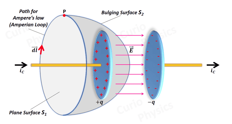

It seems that you are using ##d\vec s## in the second equation for two different entities. On the right hand side it should be a directed area element on the surface through which there is electric flux. On the left hand side it should be a directed line element on the closed loop boundary of said surface (see picture below.) To see that consider how one gets from ##\dfrac{d\Phi_E}{dt}## in the first equation to the integral in the second.
Look at the picture below. The correct form of the equation in terms of that picture should be $$\oint\vec B \cdot d\vec l=\mu_0I+\mu_0\epsilon_0\int_{S_2}\frac{\partial \vec E}{\partial t}\cdot d\vec S_2$$ Here ##d\vec l## is the line element shown as a red arrow on the Amperian loop and ##d\vec S_2## is an area element (not shown) on the bulging surface ##S_2##.
