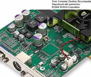

I'm an only somewhat-experienced electronics tinkerer. I'm working on a board from an older widescreen TV. It has these kinds of capacitors:
I've looked everywhere online.
Which edge is negative? The black(purple) or the grey?
There is another way to determine which side is the + side and the - side. The + side's lead will be longer than the - side's lead.
Considering that these are surface mount capacitors, I believe it will be quite difficult to determine which lead is longer. However, there is a standard for this (assuming these are compliant parts). The side with the stripe on top indicates the negative lead, and the side with the bevels indicates the positive one:
http://www.marketa.com/cht/pdf/ele/sc_series.pdf
If all else fails, measure the resistance across the leads. Then reverse the polarity and measure the resistance again. The polarity that gives the highest resistance is correct.

Not if I'm examining an existing board!
How does that tell me which is the negative lead?
See, I'm replacing all these capacitors with newer ones of a different type. I don't know the circuit. I know what's negative on my existing caps, I just need to know which way to put them in.
Looks like the negative side of a cap is always indicatged by the "stripe" or "bar".
Good. That means I put them all in correctly and don't have to redo the whole thing!:-p
