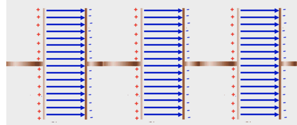

  • #31

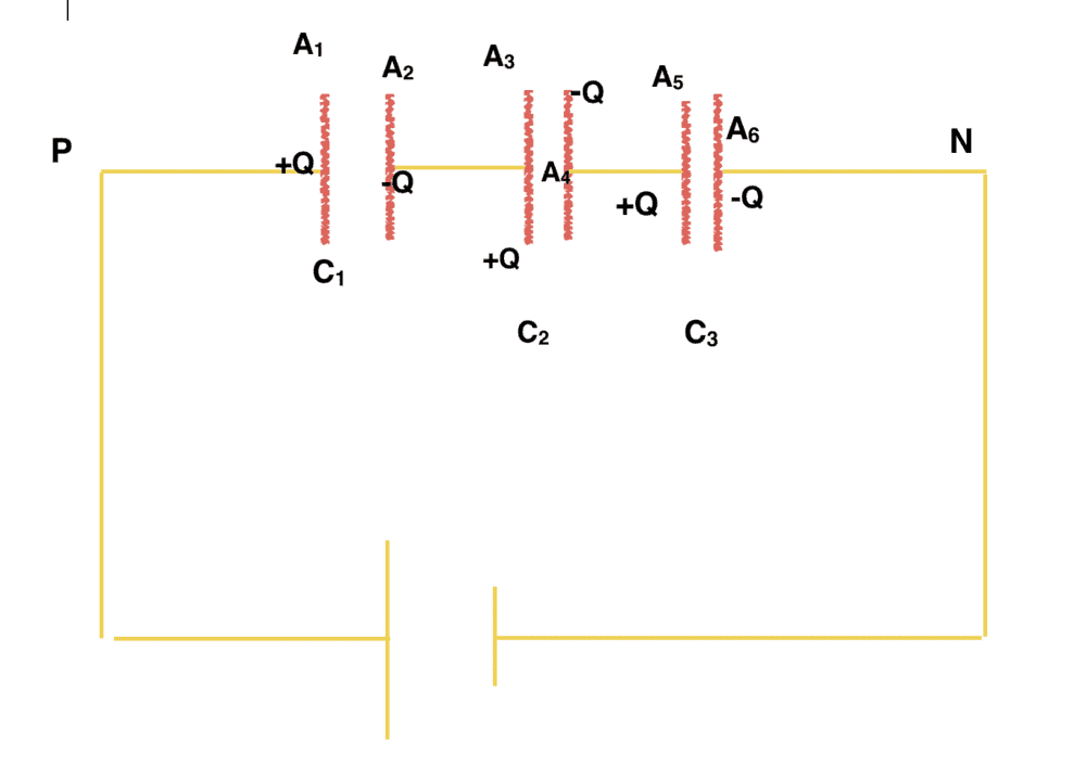

Adesh said:
Well, why there is no electric field between the connected plates? We have a negative charge on one side and positive charge on the other Why why would there be no field ?
There is zero total charge on both sides. Look at the picture again. All of the plates matter.
  • #32
Dale said:
You are getting distracted by one part of the picture and not seeing the whole picture.
Consider a spherical conductor in a vertical (up) E field. You will get positive charge on the top and negative charge on the bottom. If you incorrectly consider only the field due to the surface charges then you would assume that there is a vertical (down) E field in the conductor. But that neglects the external field. The total field is the sum of the external and the field from the surface charges, which is 0 inside the conductor.
At equilibrium, a conductor produces a surface charge distribution that exactly cancels out the external field. The shape of the conductor doesn’t matter, nor does the presence or absence of an external field. The charge distribution cancels out the external field inside the conductor, which makes the voltage the same at all points in the conductor
This has really helped me. This is the way I have understood your reply: There is a conductor between the plates A2 and A3, since I’m absence of the conductor there would be a net field, but when the conductor is placed it’s free electrons distributed themselves as such so that there is no electric field anywhere between the plates.
Have I understood you correctly? Can you please shine some light on how connecting conductor and a conductor just between them (not touching them or joining them) would affect the field differently?
  • #33
There may still be an E field outside the wire between the plates. There is only no E field inside the conductor.

  • #37
If there is a field outside the wire and between the plates, then how the work done (Voltage difference) will be zero for the purple path in post #11?
  • #38

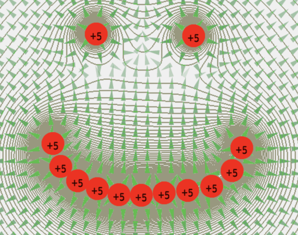

If you drew the electric field map, the two plates along with the conducting wire will be an equipotential region.
  • #39
hutchphd said:

  • #40
The curl is the infinitesimal version of the closed line integral (at least in my head). So consider a very small circular line right at the edge of the field...half the integral will be inside and entirely positive (or entirely negative) and the rest will be zero. Absent ##\frac {\partial B} {\partial t}## that nonzero result is impossible.

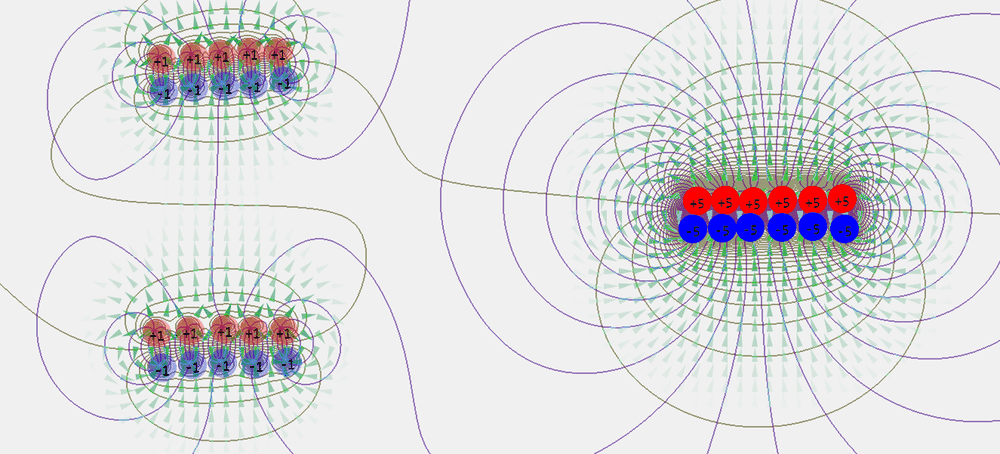

I enjoyed a simulation of the equipotential sketch as attached. Battery right side and two condensers left side. The closer pair plate charges are put, the weaker electric field between the two condensers become, I see. If you are interested in join me in Kobe university site in Japanese,
http://www2.kobe-u.ac.jp/~wakasugi/mats/elecflux/ .

  • #51
That is a nice addition. I particularly enjoy the V=0 line which threads its way from infinity, through the center plane of the devices, and out to infinity again.

  • #53
I like the drawing, but should not the field lines and the equipotential lines always be at right angles?

  • #55
If you look closely the field lines are brown and the equipotentials purple. There are both (and arrows!)
  • #56
Yes. I get that. But they are not perpendicular. And they should be.
