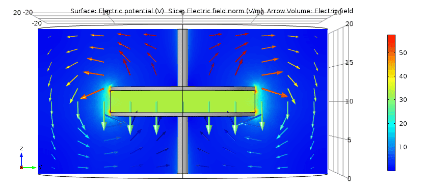

I see. You are talking about an infinitely large capacitor, but my example was a realistic case. The image below shows the electric field around a real capacitor.
(Credit to Kogence)
If it was an ideal capacitor, you were right.
It could be an infinitely large capacitor, but it is also an assumption of circuit theory that the electric field of a capacitor is confined to within the capacitor. But even if we did allow for fringing, the electric field inside a perfect conductor is still constrained to be exactly zero.

If the wire is ideal, there will be no such "electrostatic force" opposing the motion of the electrons inside the ideal wire. There is also no other source of EMF outside the battery which could oppose such an "electrostatic force" even if it were there.
Outside of the wire in the region of a physical capacitor you will get non-zero electric fields, as has been mentioned by a few others earlier in the thread. But we are not too interested in them here :wink:.
In reality, neither the wire nor the capacitor will be ideal. Perhaps yes in reality you will obtain some electric field due to the capacitor in the wire, that does some negative work on the electrons. But I don't know how you would go about analysing this. It's certainly outside the realm of circuit theory.

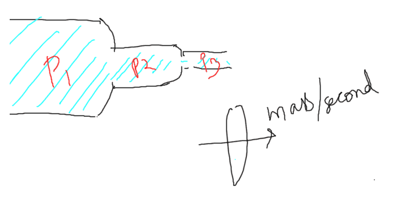

You mention the hydraulic analogy for current; it's good in some respects, but not completely. It's good in the sense that a flow of liquid is a good way to understand the continuity equation (i.e. volume of liquid into a pipe equals volume out, if it's incompressible).
However, in water pipes, each section of water exerts a contact force on adjacent sections of water. This does not happen with charge carriers in an ideal circuit! You can think of the sea of charge carriers a bit like an ideal gas, in that there is no interaction between them. The net E field inside the wire is zero, concretely because of Gauss' theorem but loosely because the sum of the forces on anyone charge carrier from the mobile charge carriers and positive cores in the wire is zero.
This just means that in an ideal wire, the charge carriers maintain their kinetic energy and no work is done on them. In some components, however, there is a non-zero electric field. In a resistor, the current density is related to the electric field by ##\vec{J} = \sigma \vec{E}##. We note that if there is any current flowing through, there will be a voltage drop across the terminals. Where does this electric field come from physically? It is due to surface charges on the wire. The charge carriers are crashing into ions in the resistor, transferring and losing their energy. This is made up for by the positive work done by the electric field, so that they maintain loosely a constant kinetic energy.
(Credit to Kogence)
I don't know what you meant by this. I talked about the direction of the net force which has nothing to do with the battery. What I really mean is that you must do a bit work to counteract the electric field generated by the capacitor in reality. Can you elucidate you answer?
Nevertheless, thank you for writing that equation. I just learned something new today.
