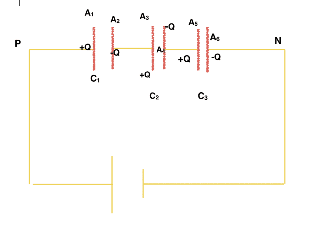

Here is a circuit diagram:
We have three capacitors, with capacitances ##C_1##, ##C_2## and ##C_3##. Plates are labelled as ##A_1, A_2, A_3 ... A_6##. Point P is connected to the positive terminal of the battery and point N is connected to the negative terminal of the battery, positive terminal of the batter will provide a charge of ##+Q## to the plate ##A_1## and a charge of ##-Q## to the plate ##A_6##. Due to mutual induction we will get a charge distribution as shown in the diagram. (Sorry if my diagram contains too much letters in a small space). Now, my book says that
let the point N be at potential 0, as point N is connected to the plate ##A_6## therefore plate ##A_6## will also be at potential 0. Assume point P to be at potential ##V##, so the plate ##A_1## will also be at potential ##V##. Let plate ##A_2## be at potential ##V_1##, since it is connected to plate ##A_3## we will have the potential of plate ##A_3## also as ##V_1##. Similarly, assume plate ##A_4## to be at potential ##V_2## so will be the plate ##A_5## as they are connected.
Now, the problem is since the plate ##A_2## and ##A_3## are oppositely charged how can they be at same potential? My intuition tells me that there will be a net field going from ##A_3## to ##A_2##, but I also know that they are connected by a conducting wire and no field exist inside the conductor. I'm just unable to connect the dots, can someone please clear this doubt.
Thank you.

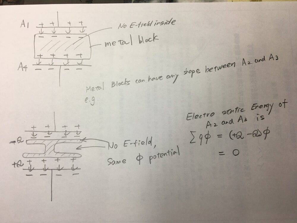

Please find attached my sketch.

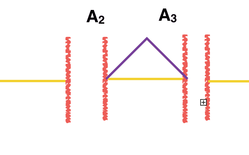

We can go from ##A_2## in a cycloid manner to ##A_3## (cycling out of the wire).
An ideal capacitor has a uniform electric field that exists only between the two of its plates. Anywhere outside the cuboid bounded by the ideal capacitor the electric field is still of zero magnitude, not just inside the wire.

Can't we follow this purple path?
You sure can, but the electric field is zero at all points along the path so the line integral is still zero. A slightly more sketchy path would be this one:
Here you would get a non-zero line integral along the green path, because of the first segment between the plates. The resolution is, I think, that there are problems with doing the line integral over the discontinuity in the second segment.
Edit: Last part is incorrect, see post #35

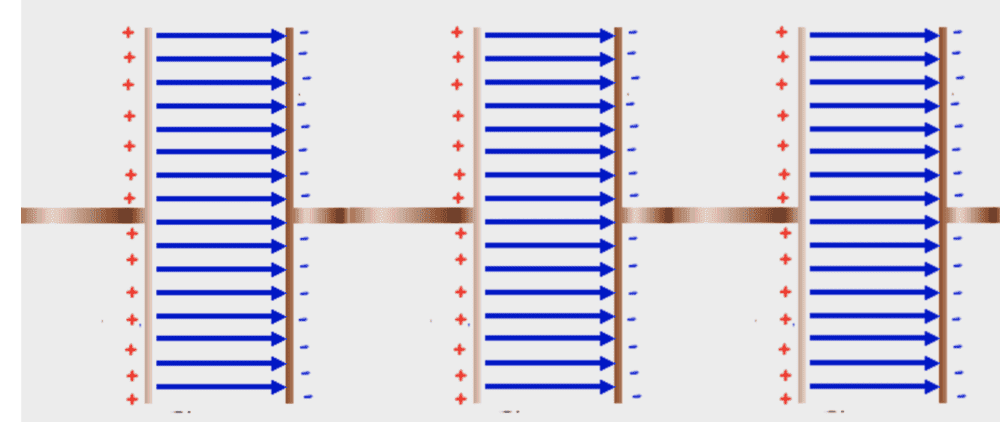

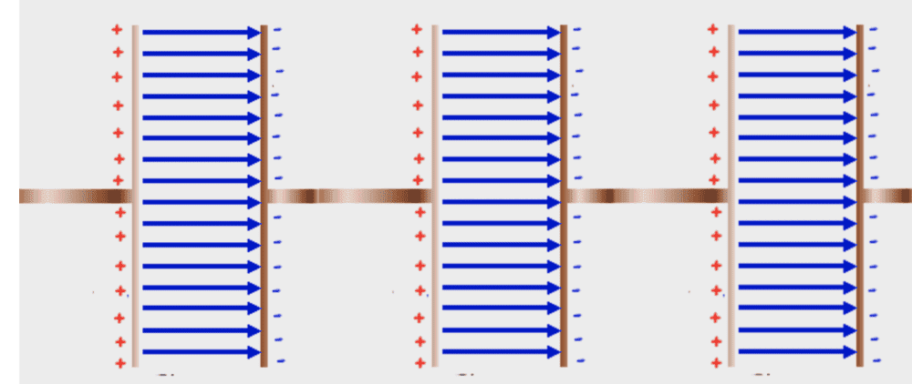

Take a single isolated (charged) capacitor, and surround it completely with a Gaussian surface. You have ##Q=0## which means that the net flux is zero. And since there are no external electric fields outside the capacitor as a whole, we deduce ##\vec{E} = \vec{0}## outside the capacitor too.
When you connect them up, there is still only an electric field between the plates. It looks like this:

Well, why there is no electric field between the connected plates? We have a negative charge on one side and positive charge on the other Why why would there be no field ?

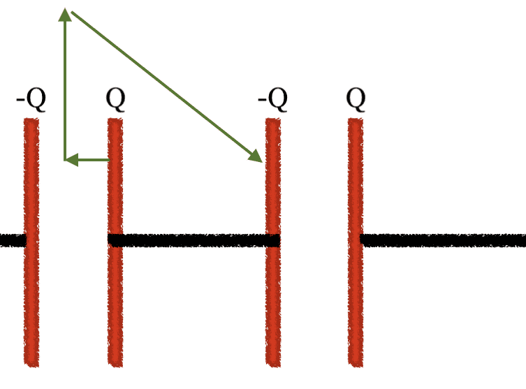

Try thinking about the superposition of electric fields at any point due to infinite sheets of charge. At any point outside of a capacitor, the total ##x## component of the electric field due to that capacitor is ##\frac{\sigma}{2\epsilon_0} - \frac{\sigma}{2\epsilon_0} = 0##.
And if you have 3 capacitors in series, the electric field between the first and second capacitor (for instance) would be ##\frac{3\sigma}{2\epsilon_0} - \frac{3\sigma}{2\epsilon_0} = 0##.

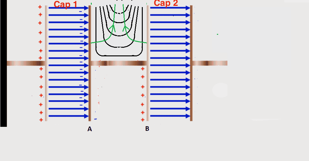

Because the field lines run from one plate to the other of the same capacitor. You are thinking of the connected plates and forgetting the other plates of the capacitors, which also have charge.

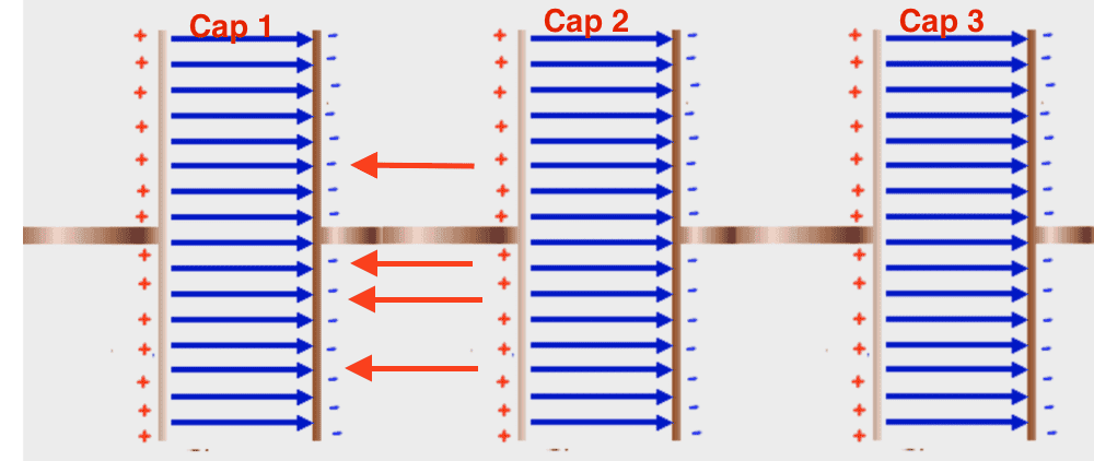

Referring to the diagram in the OP:
Shouldn't there be some surface charge buildup on the connecting wire between A2 and A3, which cancels the E-field due to capacitor plates inside the wire?
The E-field inside the wire is 0. But the E-field outside the wire is not necessarily 0.

Capacitor 1 will have no influence whatsoever outside their plates (thats what we get when we consider two oppositely charged plates of infinite dimensions we can see it here.) Now the positive plate of capacitor 2 and negative plate of capacitor 1 should have a electric field between them, the way I have drawn it.
I believe you need to consider the field contribution from the surface charges on the wire too.

That’s why I have drawn no arrows in the wire 😊.
