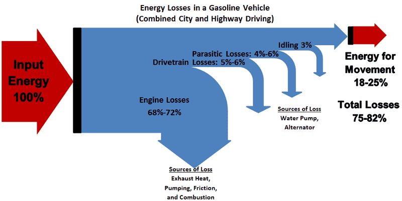

Fd for more aerodynamic car is 57% smaller.
Only 57% less torque at the driving wheels is required.
When parked, engine idling, zero torque is required, but fuel consumption is not zero.
Heat losses are still huge.
Please, see:
https://en.m.wikipedia.org/wiki/Fuel_economy_in_automobiles#Energy_considerations

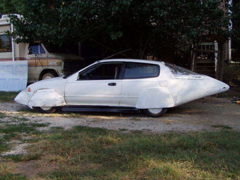

This is a case where empirical knowledge needs more weight than physics calculations. The people at Ecomodder.com (https://ecomodder.com/) study the practical effects of aerodynamic drag ad nauseam. One of their heroes modified a Honda Civic until he was able to get 50 MPG at 90 MPH, and 90 MPG at more reasonable speeds. He built the car because he drove a lot of miles, mostly at high speed, and wanted good gas mileage. The story is at: https://aerocivic.com/ and also at: https://ecomodder.com/forum/showthread.php/aerocivic-how-drop-your-cd-0-31-0-a-290.html.
The short version is that gas mileage improvement in the real world is about half the decrease in aerodynamic drag. A 10% reduction in drag typically yields about a 5% improvement in gas mileage. That will vary depending on many variables other than aerodynamic drag. Also, reductions in aerodynamic drag require other changes in order to realize the full benefit.
The best book on automobile aerodynamics is the book by Hucho: https://www.amazon.com/dp/1483108414/?tag=pfamazon01-20. Highly recommended if you are interested in the research on the subject. If you want to learn practical techniques on how to modify your car to reduce drag, the best book that I know of is the book by Julian Edgar: https://www.amazon.com/dp/1787112837/?tag=pfamazon01-20. Highly recommended if you want to modify your car and do it right.
One person, who shall not be named because that would be bragging, made a number of modifications and documented the effects on gas mileage. Link: https://ecomodder.com/forum/showthread.php/modding-06-gmc-canyon-17070.html. In that case, the gas mileage of a 2006 GMC Canyon crew cab truck was improved from 21 MPG in winter and 27 MPG in summer to 32 MPG in winter and 38 MPG in summer.
He claim he improve Cd from 0.31 to 0.17
He improve civic top speed from OEM -152km/h to 225km/h?
that seems unreal
152km/h(42m/s)
F=75kW / 42
F=1777N
Cd=1777N /0.5 x42(square) x1,84m2 x1,225
=0.89
Cd from math is too big, top speed is too small or other resistance forces are not negligible)something is wrong here, car with 75kW must have higer top speed, 152km/h is too low

That seems to small. For 42% reuduction of Cd only 7% drop in f.c.
I took numbers out of thin air, but the equation shows that it depends on what the 5L/100km is used for. A lot is lost in mechanical inefficiencies or other uses (like A/C for example). That is why you need to refer to the actual power output of the first scenario.
If you imagine that the entire 5L/100km of fuel is converted to fight the drag force only - no other losses - then then ##P_1 = \frac{1}{2}\rho C_{d\ 1} A v^3## and the whole equation reduces to:
$$\frac{\left(\frac{dV_f}{dx}\right)_2}{\left(\frac{dV_f}{dx}\right)_1} = 1 - \frac{C_{d\ 1} - C_{d\ 2}}{C_{d\ 1}} = \frac{C_{d\ 2}}{C_{d\ 1}}$$
Or a ratio of 0.5714 in our case, which corresponds to the 4/7 (##= \frac{C_{d\ 2}}{C_{d\ 1}}##) of @jbriggs444 in post #22.
This equation and the one from @jbriggs444 just show that your fuel consumption reduction will be somewhere between 0 and ##\left(1- \frac{C_{d\ 2}}{C_{d\ 1}}\right)## depending on the actual portion of fuel used to fight the drag force in the first scenario.
=0.89
Answer: Other resistance forces are not negligible.
Your calculations just demonstrate my preceding point.
There exists a large body of research into vehicle fuel efficiency. Much of that is summarized in this online calculator: https://ecomodder.com/forum/tool-aero-rolling-resistance.php.
Engine efficiency varies with RPM and throttle opening. Engine efficiency is measured as BSFC, Brake Specific Fuel Consumption, and shown in BSFC charts. Some example BSFC charts: https://ecomodder.com/forum/showthread.php/bsfc-chart-thread-post-em-if-you-got-1466.html.
The top speed of a vehicle is dependent on the power available at the top speed. A vehicle designed for top speed will have gear ratios such that the engine will be at peak power RPM at the top speed. A vehicle designed for gas mileage will have gear ratios such that the engine will be at the best efficiency for the power needed at a particular speed.
