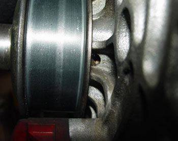

typical automotive water pump is not totally sealed. Water will leak thru the impeller. These pumps have a "weep hole" that will drip coolant once the front impeller seal wears the point of failure. It is possible to loose quote a bit of coolant because of this. The weep hole is purposely drilled when manufactured to let the driver know there is a seal failure. If we had a total seal pump very little coolant would leak and the drip would stop once coolant in the pump housing had dripped dry.
  • Close-up photo of an automotive water pump showing the metal pulley or bearing hub on the left and the pump housing with a small weep hole visible on its face.
