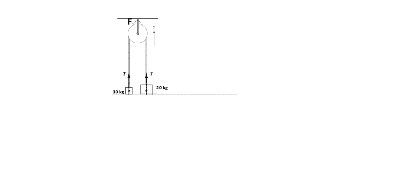

"There is a pulley with 2 blocks on the table.Force "F" is acting on it ,as it can be seen here
A=10 kg and B=20 kg
F=294 N
Now,my exact problem is my teacher says "there is no contact force between A and the table.."
Why block A is not pushing against table while block B is?
:[/B]
F=2T
T=147 N
As it is not a numerical problem instead conceptual doubt,I can not attempt anything.But I will try some in order to obey the guidelines of filling the template.Condition for normal force is there should be deformation.The objects should press against each other.I don't know why there is no deformation.Evertytime when something is on the table
there is normal force equal to weight.
Why not in this case?Why block A is not pushing against table while block B is?

What is the normal force down on the table for the larger block?
If you moved the table 1cm down and released the blocks, what would happen?

Touch the table with your hand and move your hand on the surface. You feel the surface of the table, but your hand does not push it. there is contact, but the weight of your hand is opposed by your muscles, the normal force between the table and your hand is zero.
The situation is the same here. What should be the tension so as it keeps block A in rest just touching the table?
What should be the normal force acting on block B?

It seems to me that there is a problem here with the problem as it's stated.
In order that block A not accelerate upward, the most that T can be is 10g = 98 N ,(assuming g = 9.8 m/s2, which seems to be what's assumed here.)
Therefore, the upper limit for F is 196 N.
In that case, (F = 196 N) we have T =98 N so the net force on block A is:
T - mAg = 98 - 10⋅9.8 = 0​
So, block A is resting on the table. Does the table exert any force on the block?

There is a massless pulley on which force "F" is applied.The pulley is connected to block A and block B.Both of which were resting on a ground when force "F" was being applied.A=10 kg and B=20 kg
Question was find acceleration of A and B.
But I have a solution for that.My teacher has given me.But in that solution it is said that "there is no contact force between A and the table"
That's my exact problem...

Quite so. So consider starting with each block resting happily on the table, spring slack. Each weight deforms the table slightly. Now gradually raise the pulley. The tension increases in the string as the deformations decrease. At some point, the deformation from the lighter block becomes zero. What is the normal force there now?
Zero .(Normal force on lighter block.)
Right. Does that answer your question?
Initially the blocks were in rest on the table. Then the force was applied. That force accelerated the pulley. The raising of the pulley made the rope taut. Block A lost contact with the ground.
The net force acting on the whole system became F-WA-WB+NB=NB. This is still an upward net force, so the CM accelerates upward. At the end, B also loses contact with the ground. With no interaction between the blocks and the ground, the net force is just zero. The CM does not accelerate any more, but the pulley does, and so are the blocks.
The blocks accelerate with respect to the accelerating pulley, and the relative accelerations have the same magnitude.

OK. I'm going to help you resolve this dilemma on your own.
Can we agree that the maximum contact force that the table can exert on mass A in this system is 9.8 N (it's weight), and the minimum that it can exert on mass A is zero (assuming that mass A is not glued to the table)?
Chet
Yes.
gracy said:
Yes.
Excellent. OK, for each of these two extremes, (using a free body diagram on mass A) write down the force balance equation on mass A (including the ma term) that would apply.

In case of maximum contact force
Normal contact force=weight
This case occurs when force 294 N is not applied,therefore tension force is absent.Hence string will be slack.
.acceleration of block A=0
And for minimum contact force on A
i.e zero.This condition is achieved when force is applied String is taut ,hence tension force is present.
T-w(weight of A)=Mass of A multiplied by acceleration of A.As block A accelerates,it loses contact from ground so normal contact force becomes zero.So,not appears in equation.
Right?

Well, this is not exactly what I had in mind, but your analysis for the case of zero contact force is exactly correct. And your conclusion regarding the contact force is correct. As soon as the tension force T = 147 N gets applied, the contact force changes discontinuously from 98 N immediately before application of the tension to 0 immediately after the application of the tension. This is because its acceleration is positive (5 m/s^2), its displacement above the table is ##\frac{1}{2}at^2##, and for all t > 0, this is positive.
