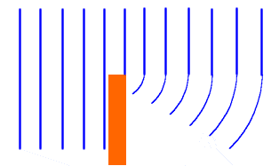

Idoubt said:
To understand this you have to think of light as a wave and not a ray. For example suppose you have a tub of water and you place some sort of wooden surface vertically in it with a slit.
If you disturb the water you will see waves propagating in all directions on the surface.
When the waves hit the wood it will pass through the slit, but it won't emerge through the slit on the other side as a straight line, it will still spread in concentric circles ( well semi-circles ) on the other side of the surface with the slit as the centre.
The water waves are made up of material where as light waves are electromagnetic waves. So that can't be example of diffraction.

You do not need an aperture to diffract the wave. You can have a finite plate or wedge and still achieve diffraction. Making it an infinite object of course makes it much easier to calculate a solution or approximate one (ie. UTD, Sommerfeld half-plane solution, etc.) but the diffraction is a localized effect. We can easily create a finite scatterer and observe the typical diffraction behavior and doing so is a common problem in modeling high frequency scattering.
EDIT: Or perhaps you are misunderstanding my meaning. For example, Idoubt posted a picture of what I would consider is the diffraction of a monochromatic plane wave due to an infinite half-plane perfect electrical conductor (a problem that Sommerfeld solved almost a century ago and is of particular interest to us since a half-plane represents an interesting problem for a finite plate diffraction approximation).
