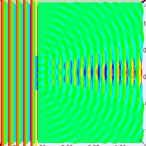

In the first image, the water waves after passing through the slit, form an almost semi-circular shape...However, in the second image, the water waves form the same almost semi-circular shape, even though gap between obstacles in the two images is not same...So what is this "greater diffraction"?...I hope my question makes some sense now...

The more light is diverted from the straight-through horizontal direction, the greater is the diffraction.

If you look very closely at the two images i posted, you can see that there is the same semi-circular shape of water waves in both images...So where is this "more bending of light in greater diffraction"?

However, the intensity of the deflected light is much greater in one image than the other. If you were to place a screen behind the slit, in one case you'd see a small bright spot directly behind the slit and in the other you'd see a larger bright spot.

I can only describe it simply as "When the waves create a more perfect semi-circle around the barrier, diffraction is considered greater (the gap being equal to the wavelength of the wave)".

But in the second case it would not be as bright as less light (due to smaller opening) is distributed over a wider range of angles.

The equation for the angle, θ, of the first minimum with respect to the horizontal is sinθ = λ/w. This defines the extent of the main area of light on a screen. As you decrease w, the angle increases, i.e., more diffraction.

That is true. However, the off-axis areas are still brighter than they otherwise would be, a situation which is reasonably described by the informal "more bending of the light" that OP was asking about.

The shape of the wave front is basically to do with the overall (radial) path length and it looks pretty circular. That doesn't change much as the slot is widened - in fact. at infinity, the wave fronts are all circular. What does change A LOT is the width of the region of maximum wave power. The wider the slot, the narrow is the region. That is what Diffraction is all about.
