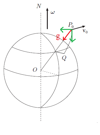

Centrifugal force due to rotation of the Earth has among its effects the deviation towards the equator of a ball falling from height ##h## vertically on Earth.
I do not understand what is the inertial explanation of this phenomenon. Once the ball is released there is no centripetal force that causes it to curve its path, hence it will move in elliptic trajectory (only due to gravity).
Why does the ball move towards the equator also?

In this drawing I marked in red ##\vec{g}## and in green its component. One of this component is vertical and produces a displacement southwards during the fall. Is that correct?
Southwards is misleading: the latitude does not change.

Soren4 said:
So actually is gravity that pulls the ball slightly towards the equator?
Gravity has a non-zero component toward the plane containing the equator and the centrifugal force does not. So yes, you could say that gravity is the force that produces a displacement toward the equator.
On the other hand, if you consider "south" as pointing toward the equator in the horizontal direction then gravity has a non-zero northward component while centrifugal force has a non-zero southward component and any southward component in the fall direction traces clearly to the centrifugal force.
Edit: Note that details of the above description can vary depending on exactly what you mean by "horizontal".
