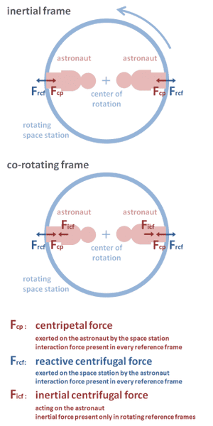

Some call it "reactive centrifugal force":
http://en.wikipedia.org/wiki/Reactive_centrifugal_force
Note that contrary to the "inertial centrifugal force" in a rotating ref. frame this "reactive centrifugal force" is an interaction force that exists in all ref. frames. See the table in this section for a comparison of the two:
http://en.wikipedia.org/wiki/Reactive_centrifugal_force#Relation_to_inertial_centrifugal_force
Here another example to explain all three forces, a rotating space station with two astronauts:
