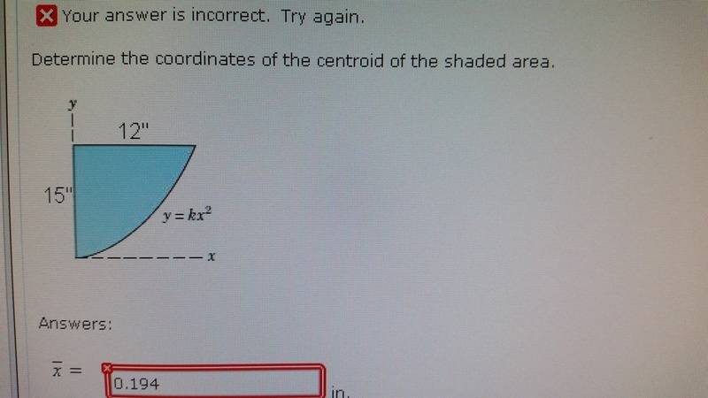

Find the coordinates of the centroid of the uniform area.

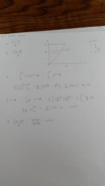

equations for centroid coordinates at the top of my paper.
How does k go from the denominator to the numerator of your integrals as you are evaluating them?
(2/3k)(58.1)
=(.667k)(58.1)
=38.7k
where k is a constant. And i treated the other integral similarly.
In one of your steps you basically said ##\sqrt{\frac{y}{k}} =\frac{1}{k}\sqrt{y}##
Also Dr. Courtney's point still stands... it's not 2/3k it's 2/(3k)
Ok thanks Dr. Courtney and Nathanael. I now have 38/k. In my final answer the k's cancel out and I am left with the same 7.5/38.7.
38.7/k is still not right. It should be 38.7/√k
When you find the x-coordinate of the centroid, you should be integrating with respect to x.
The "dA" in the formula ##\bar x=\frac{1}{A}\int xdA## is the area of the thin strip between x and x+dx.
Wouldnt it be easier to integrate with respect to y, because of the shaded region is above the curve.
It's not about what is easier, it's simply wrong.
When you integrate with respect to y, you are taking horizontal strips of area, right? Well when you find the x-coordinate of the centroid you want to take vertical strips of area. The reason for this is that you want to take strips of area which all have the same x-value, and then multiply them by that x-value. You just can't do this when you integrate w.r.t. y.
= ##1/2 \int kx^3dx## does this look ok?
kx2dx is the area under the curve. Try to figure out a way to find the area above the curve.
Also where did the 1/A go? And where did this 1/2 come from? (Are you saying the area is 2?)
