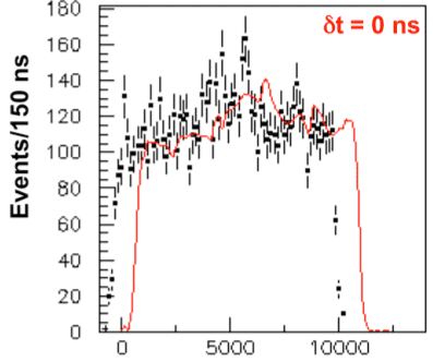

  • #161
TrickyDicky said:
It is not as simple as that and anyone who has bothered to look up the paper or knows about neutrino detection knows it,
That's exactly how it's done. You have the neutrino beam produced for a fraction of a second every SPS cycle, and the detector sees more events - substantially more - in this period than at other times. Furthermore, this tracks the accelerator operation at all time periods. Machine off for a week? No neutrinos that week.
You can see it graphically in the paper; figure 11.

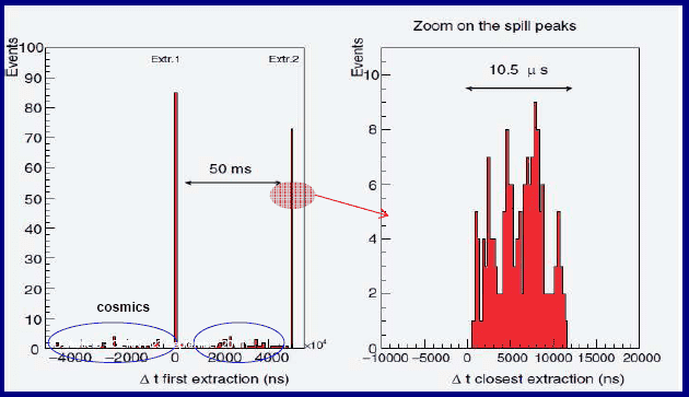

  • #165
This is the statistical process I referred to
This might be misleading, neutrinos are detected in a location at some rate at all times, regardless the existence of beams directed to that location.

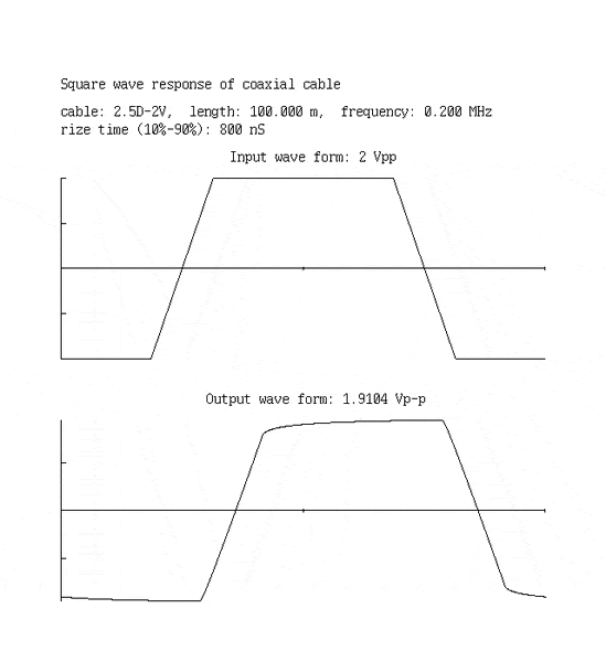

  • #170
Read the article, and they were careful. That being said:
a) The 8.3 km fiber optic, including Tx and Rx circuits, has some temperature coefficient of group delay. Since the GD is ROM 30 us, and they desire a couple ns cal error, then was the temperature at the cal times close enough to the temperature at pulse measurement times?
b) Would like to know more detail on how the digitizer time stamping was done. Concern is with front end latencies. My sense is they probably did fine here, but it would put everybody to sleep actually explaining it.
c) What if the proton pulse shape has a good-size temperature coefficient? Then will the pulse shape statistical treatment they did still work and not lead to errors? Because the pulse, 10 us long, might then give problems with the way they modeled it if it varies quite slowly.

  • #172
I'd think, if the problem came from any sort of temperature effect that the experiment would have to see a large seasonal variation; and, the seem to have been very careful to demonstrate that they, in fact, do not.

kmarinas86 said:
Also, just because the extraction time is on the order of ten microseconds does not in away forbid time resolutions on the order of nanoseconds. Due to the relatively steep rise and fall of the beginning and end of each pulse, the beginning and end time of early arrival of the barrage of neutrinos can be obviously ascertained using atomic clocks of nanosecond resolution.
.. (60.7 ± 6.9 (stat.) ± 7.4 (sys.)) ns was measured.
Perhaps they really meant to say 'was calculated'
The time of flight of CNGS neutrinos (TOFν) cannot be precisely measured at the single interaction level since any proton in the 10.5 μs extraction time may produce the neutrino detected by OPERA. However, by measuring the time distributions of protons for each extraction for which neutrino interactions are observed in the detector, and summing them together, after proper normalisation one obtains the probability density function (PDF) of the time of emission of the neutrinos within the duration of extraction.
So they are burrowing statistically into a 10.5us rectangle, to resolve to 60.7ns.
- that's a statistics 'gain' of ~173, and you do need to be very careful of your PDF/correlation assumptions when chasing this much 'gain', especially indirectly.
I make it that a skew error of ~1.005292190792 in the Real:Assumed shape of that rectangle. will deliver the same time result.
