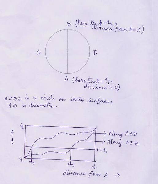

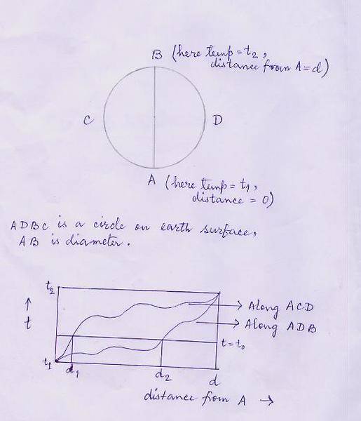

An alternative heuristic approach: See attached image. Let ADBC be a great circle on Earth surface.
AB diameter. At A, temperature is t1, at B temperature is t2. Let us imagine two men moving at same speed from A to B along paths ACB and ADB respectively. The distance from A to B =d. Now the men are recording temperatures continuously. We draw the graphs of the temperatures vs distance on the same axes.
Now if we draw a straight line corresponding to any temperature t=t0, (between t1 and t2) parallel to distance axis. Both the temperature curves shall cut this line at least once (intermediate value theorem).
This two intersection points are our answer.

ssd - Maybe I am misunderstanding your argument, but I don't see why the two intersection points ##(d_1, t_0)## and ##(d_2, t_0)## correspond to points on "exact opposite sides of the Earth" as the problem requires. In other words, what guarantees that ##d_1 + d_2## equals the arc length from ##A## to ##B##?
Oh, that is right. My answer is wrong. I missed the "exact" opposite part.
Well, let us consider that the first man is moving from A to B via C and the second man is moving from B to A via D. As before the are recording temperature continuously. They start at same time and move at same constant speed. This implies that they are always exactly on opposite points of a diameter.
Consider the graph of the difference in the temperature readings (of same instant) of two men vs the distance. Let, t1<t2. The graph starts with -ve value and ends with +ve value. According to the given conditions it must intersect the distance axis (that is, will attain value 0) somewhere between distance 0 to d. That point is the answer. If t1=t2 then the start and end point is one answer.

As far as I can tell this is the solution that jbunniii gave, just with a lot less notation.
