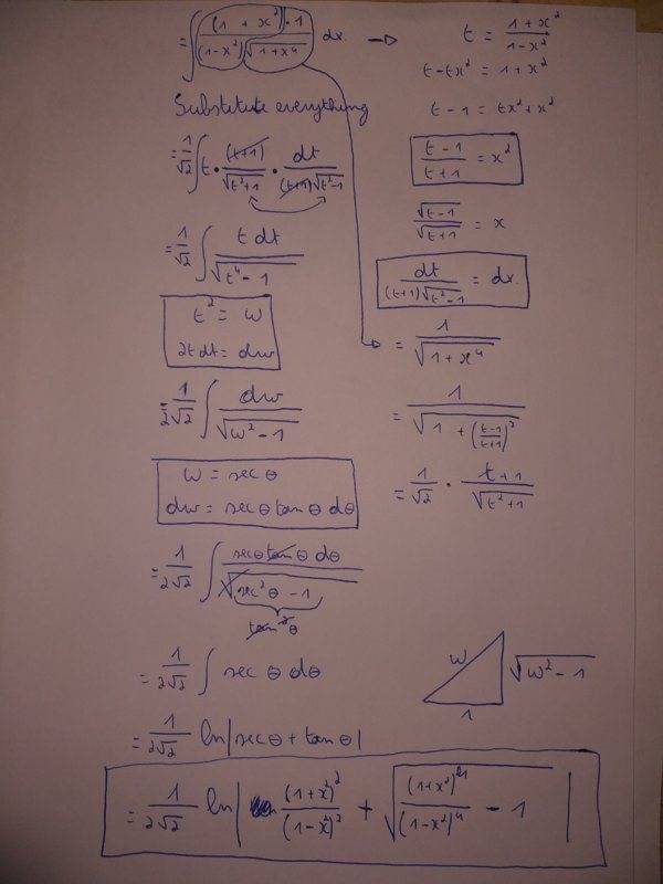

  • #185
yip said:
Try [tex]\int{\frac{(1+x^{2})dx}{(1-x^{2})\sqrt{1+x^{4}}}}[/tex]
(forgot to put the integral sign in, it is now fixed)
This is my answer, tell me if i did something wrong :).
  • #186
this is a “simpler” result I got from unraveling your solution & re-packaging it. I want to figure out how to get it in this form in a more natural way. As of now I’m stuck. Right now I’m working with a Pythagorean triangle
Adjacent = 1-x^2
Opposite = x*sqrt(2)
Hypotenuse = sqrt(1+x^4)
and the solution is 1/sqrt(2)*ln(sec(angle)+tan(angle)) + C
I see some kind of pattern here but it’s a little opaque. Any way to clear this up & produce a really elegant solution?
