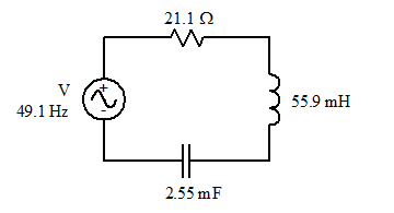

The capacitor is changed so that the largest possible current is supplied by the source.
Enter the value of the capacitive reactance when this change is made.
Give your answer in Ohms (Ω). A unit is not required with your answer.
The circuit is powered by an alternating voltage source, which produces a voltage that varies sinusoidally and has an RMS voltage of V.
- The frequency of the voltage source is 49.1 Hz and the inductor has an inductance of 55.9 mH.
Calculate the inductive reactance (XL) of the inductor.
Give your answer in units of Ohms (Ω) = 17.2
- The capacitor has a capacitance of 2.55 mF.
Calculate the capacitive reactance (XC) of the capacitor. The frequency is still 49.1 Hz.
Again, give your answer in units of Ohms (Ω) = 1.27
- The resistor has a resistance of 21.1 Ω.
Calculate the impedance (Z) of the RLC network.
Give your answer in units of Ohms (Ω) = 26.4
Im not sure what this question is asking me or what equation to use to calculate it either.
What is the sign of the capacitive reactance and inductive reactance?
How are your components interconnected? Is it a series RLC circuit like this?
Circuit schematic of a series RLC loop with an AC voltage source labeled V, 49.1 Hz, a 21.1 Ω resistor, a 55.9 mH inductor and a 2.55 mF capacitor.
  • Circuit schematic of a series RLC loop with an AC voltage source labeled V, 49.1 Hz, a 21.1 Ω resistor, a 55.9 mH inductor and a 2.55 mF capacitor.
