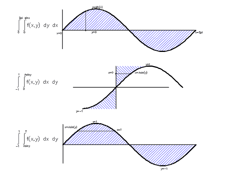

edit:
The top graph is the correct bounds that you have to begin with. Then you want to change the order.
The second graph is what you described when you took x from 0 to arcsin(y) and then y from -1 to 1.
You need to come up with what should replace the '?' in the third graph that will get you what you want. Remember that the arcsin only goes up to the first peak there, then stops, so you can't use arcsin(y) to arcsin(y) (which would give you 0). You have to split it up into pieces.
Also, will you get that portion of the area below the x-axis? Do you need to split it up into two integrals or can you do it all in one?

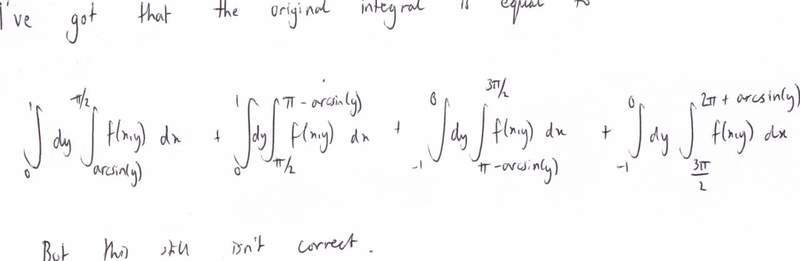

Thanks for the graphs I think they've given me more of an idea of what I should be doing now. I tired to explain my working using the Latex Reference but I couldn't use it so I've attached what I've done so far. Any more comments would be great! Thanks!

You broke up the function into working sections. The only thing is, in the original, the part of the shaded region that falls below the y-axis is treated as negative. The integrals you have will give you a positive value for the integral of that region.
Even when I take the regions below the x-axis to be negative I'm still not getting my solution to be correct.
You sure? It seems to be working for me, unless I'm making an arithmetic error. You don't need four integrals, by the way, but it should still work (you can go straight from one function to another without having the vertical x=pi/2 and x=3pi/2 in between). What are you checking it against?
I'm checking it through Maple but it dosen't make sense that it's wrong. I can see exactly how the answer should be correct.
Sorry! I'm being a massive idiot, I had a minus where I should have had a + it's completely correct! Thanks for all your help I really feel I understand this topic a lot better now.
