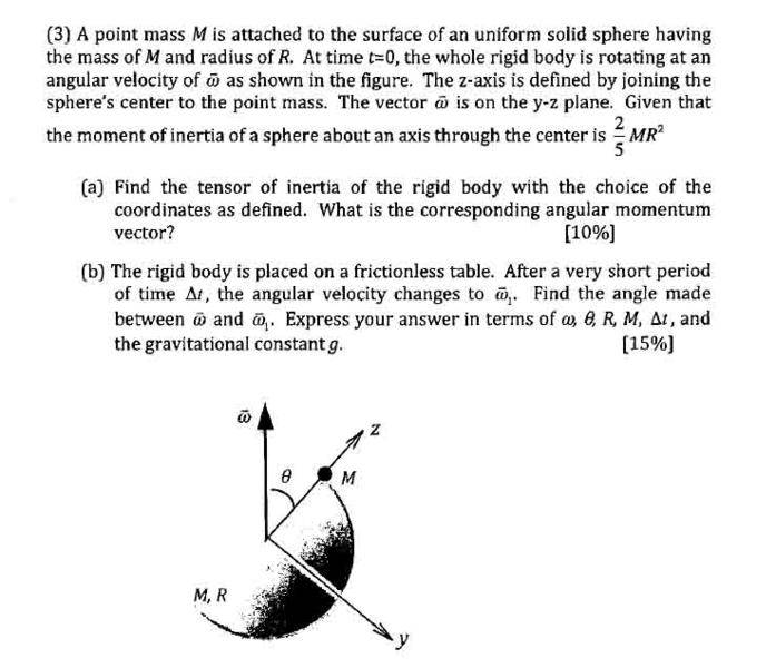

I don't know how to solve part(b).
See the photo Q3 for the question.
See the photo 2010Q3
I found the torque and hence the new angular momentum vector. But I wonder how could this help me to find the angle between the new and old angular velocity vector.
  • Problem statement with text, followed by a diagram of a solid sphere of mass M and radius R with a point mass M on its surface, a z-axis through the sphere's center and the point mass, a y-axis, and the angular velocity vector omega at angle theta from the y-axis.
