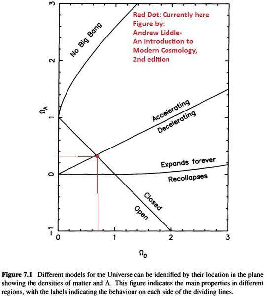

On the other hand, I am still unable to understand the basic of it... If the curvature of the universe can change any time (changing the fate of the universe) then there's no predictivity in the theory- you can say that today the universe is almost flat ([itex]Ω_{mat}=0.7, Ω_{Λ}=0.3[/itex] approximately, so sum to 1=flat universe) , but tomorrow it may be closed instead of open... (check attachment)

In the Friedmann universe, the value of k is what determines whether the curvature of the space sections is positive, negative or zero. K is a constant. If it's positive today, it's positive tomorrow.
yes but that would mean the the curvature doesn't/cannot change by time (what I initially asked/proposed)... If curvature is to be changed (in sign) then the K would also need to change...
In other words, a universe started with positive curvature, can't change to negative and vice versa...

The constancy of k doesn't depend on the equation of state. The only assumptions that go into it are that the space sections must be homogeneous and isotropic. (And Einstein's Equations!)
Would it be possible to use models with different ##k## for different phases as well? Or is there no way of "patching together" models with different ##k## into a single overall spacetime?
To patch two regions of spacetime together, a condition is that the intrinsic curvature of the "seam" must be the same when viewed from either side. So in the Friedmann case, the value of k would have to be the same in both patches.
