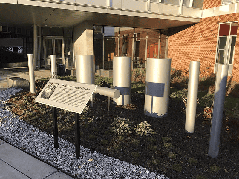

I recall this interesting remembrance of Joseph Weber at Maryland. He was subject to some intense criticism as I remember.
Outdoor garden with several tall brushed-metal cylinders of varying heights set in mulch beside a brick building, with a plaque on a stand reading Weber Memorial Garden.
