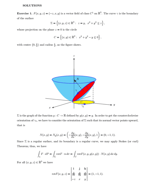

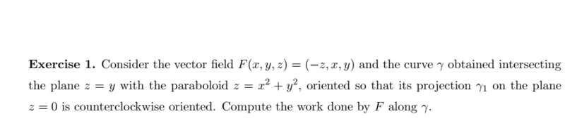

Typeset textbook exercise 1: vector field F(x, y, z) = (-z, x, y) and curve gamma from the plane z = y intersecting the paraboloid z = x^2 + y^2, with projection gamma_1 onto z = 0 counterclockwise; compute work along gamma.
Here is the solutions using two different methods: the first method is the Green theorem and the second is the simple path integration method:

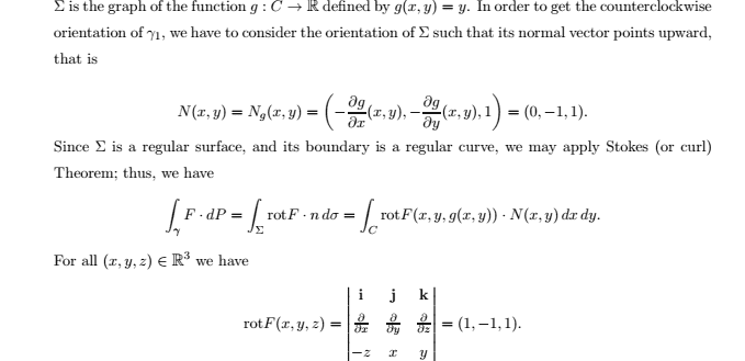

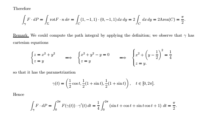

My question is why they integrate over [0.2pi] in the path integration method while they integrate within [0. pi] in the green method (I do agree with it)?
Diagram of a paraboloid cup opening upward with a red tilted planar cap cut by the plane z = y, a normal vector N, boundary curve gamma, and the yellow base circle C in the xy-plane with axes x, y, z.

Typeset worked solution: Stokes or Green step giving the integral of F dP equals the double integral of (1,-1,1)·(0,-1,1) dx dy, which is 2 times the area of C equal to pi/2; remark parametrizing the curve with cartesian equations and gamma(t) = (cos t/2, (1+sin t)/2, (1+sin t)/2) for t in [0,2pi], leading to the integral equal to pi/2.

They don’t seem to be using any parametrization at all when applying Stokes’ theorem.
The value of an integral does not depend on the parametrization. You could have picked a parameter taking values in ##[-200.5,\pi]## and you would get the same result (although a bit more annoying expressions for the differentials).
for the stock theroem they calculate the surface by integrating from [0 ,pi], this is why i don't understand why they didn't do the same for the path integral
