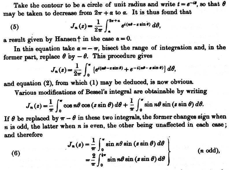

Attached is a definite integral copy from page 20 of http://ia601507.us.archive.org/5/items/ATreatiseOnTheTheoryOfBesselFunctions/Watson-ATreatiseOnTheTheoryOfBesselFunctions.pdf
It said
[tex]\int_{\alpha}^{2\pi+\alpha}e^{j(n\theta-z\sin\theta)}d\theta[/tex]
I can understand ##\alpha=-\pi## and change the integral to
[tex]\int_{-\pi}^{\pi}e^{j(n\theta-z\sin\theta)}d\theta=\int_{0}^{\pi}e^{j(n\theta-z\sin\theta)}d\theta-\int_{0}^{\pi}e^{j(n\theta-z\sin\theta)}d\theta[/tex]
But I can not agree with changing ##\theta## to ##-\theta## in half of the equation so
[tex]J_n(z)=\int_0^{\pi}\left[e^{j(n\theta-z\sin\theta)}+e^{-j(n\theta-z\sin\theta)}\right]d\theta[/tex]
You cannot just at will, substitute second part of the equation from ##\theta## to ##-\theta## and leave the first part ##\theta## still ##\theta##.
Am I missing the point?
Thanks
Surely you can. It's a basic property of integration that if [itex]c \in [a,b][/itex],
[tex]\int_a^b f(x) \mathrm{d}x =\int_a^c f(x) \mathrm{d}x + \int_c^b f(x) \mathrm{d}x[/tex]
Now you have two separate integrals that can of course be treated completely independently, including changing variables. In particular, after bisecting the interval of your integral, the first part becomes
[tex]\int_{-\pi}^{0} e^{i(n\theta-z\sin\theta)}\mathrm{d}\theta = - \int_{0}^{\pi} e^{i(n(-\theta)-z\sin(-\theta))}\mathrm{d}(-\theta) = \int_{0}^{\pi} e^{-i(n\theta-z\sin\theta)}\mathrm{d}\theta[/tex]
so that
[tex]\int_{-\pi}^{\pi} e^{i(n\theta-z\sin\theta)}\mathrm{d}\theta = \int_{-\pi}^{0} e^{i(n\theta-z\sin\theta)}\mathrm{d}\theta + \int_{0}^{\pi} e^{i(n\theta-z\sin\theta)}\mathrm{d}\theta[/tex]
[tex]= \int_{0}^{\pi} e^{-i(n\theta-z\sin\theta)}\mathrm{d}\theta + \int_{0}^{\pi} e^{i(n\theta-z\sin\theta)}\mathrm{d}\theta = \int_0^{\pi} e^{-i(n\theta-z\sin\theta)} + e^{i(n\theta-z\sin\theta)}\mathrm{d}\theta[/tex]
by the linearity of integration, resulting in the final expression given in your attachment.

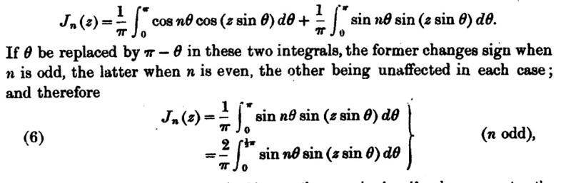

I have another changing interval question. See attachment
[tex]J_n(z)=\frac{1}{\pi}\int_0^{\pi}\cos(n\theta)\cos(z\sin\theta)d\theta\;+\;\frac{1}{\pi} \int_0^{\pi}\sin(n\theta)\sin(z\sin\theta)d\theta[/tex]
The article claimed if we substitute [itex]\theta=\pi-\theta[/itex], if [itex]n[/itex] is odd, then:
[tex]J_n(z)=\frac{1}{\pi}\int_0^{\pi}\sin(n\theta)\sin(z\sin\theta)d\theta[/tex]
I just don't get this. I know
[tex]\sin(\pi-\theta)=\sin\theta[/tex]
[tex]\cos[n(\pi-\theta)]=\cos(n\pi)\cos(n\theta)+\sin(n\pi)\sin(n\theta)=\cos(n\pi)\cos(n\theta)=(-1)^n\cos(n\theta)[/tex]
[tex]\sin[n(\pi-\theta)]=\sin(n\pi)\cos(n\theta)-\cos(n\pi)\sin(n\theta)=-\cos(n\pi)\sin(n\theta)=(-1)^n\sin(n\theta)[/tex]
Therefore:
[tex]J_n(z)=\frac{1}{\pi}\int_0^{\pi}\cos(n\theta)\cos(z\sin\theta)d\theta\;+\;\frac{1}{\pi} \int_0^{\pi}\sin(n\theta)\sin(z\sin\theta)d\theta=\frac{1}{\pi}\int_{\pi}^{0}-\cos(n\theta)\cos(z\sin\theta)d\theta\;-\;\frac{1}{\pi} \int_{\pi}^{0}\sin(n\theta)\sin(z\sin\theta)d\theta[/tex]
For [itex]n[/itex] is ODD.
I can't get (6) in the attached copy. Please help.

Let's see. The result (6) only applies for odd n, so keeping that in mind we can show some symmetry properties:
[tex]J_n(z)= \frac{1}{\pi} \int_0^\pi \cos n\theta\cos(z\sin\theta)\mathrm{d}\theta + \frac{1}{\pi} \int_0^\pi \sin n\theta\sin(z\sin\theta)\mathrm{d}\theta[/tex]
[tex]=\frac{1}{\pi} \int_\pi^0 \cos n(\pi-\theta)\cos(z\sin(\pi-\theta))\mathrm{d}(-\theta) + \frac{1}{\pi} \int_\pi^0 \sin n(\pi-\theta)\sin(z\sin(\pi-\theta))\mathrm{d}(-\theta)[/tex]
[tex]=\frac{1}{\pi} \int_0^\pi \cos n\pi \cos n\theta\cos(z\sin\theta)\mathrm{d}\theta + \frac{1}{\pi} \int_0^\pi \sin n\pi\sin n\theta\sin(z\sin\theta)\mathrm{d}\theta[/tex]
For odd n,
[tex]=-\frac{1}{\pi} \int_0^\pi\cos n\theta\cos(z\sin\theta)\mathrm{d}\theta + \frac{1}{\pi} \int_0^\pi \sin n\theta\sin(z\sin\theta)\mathrm{d}\theta[/tex]
So, let's define the initial integrals as [itex]I_1, I_2[/itex]. The last line gives us
[tex]J_n(z)=I_1+I_2=-I_1+I_2 \implies I_1=0[/tex].
If this is what you didn't get, it's because the two integrals are independent, the general result is only achieved if [itex]I_1=-I_1=0[/itex], independent of z.
In addition, the very last equality in the attachment holds as what the change of variables "did" was essentially to mirror the interval from "0 to π" to "π to 0". What's written above shows that it does not effect the value of the integrand in any point of the interval, and so the integrand must be symmetric over the interval, so that
[tex]J_n(z)=I_2=\frac{1}{\pi} \int_0^\pi \sin n\theta\sin(z\sin\theta)\mathrm{d}\theta=\frac{2}{\pi} \int_0^\frac{\pi}{2} \sin n\theta\sin(z\sin\theta)\mathrm{d}\theta[/tex]
I hope I didn't make any careless mistakes here, this was a bit lengthier than the previous one to write out.

Thanks for the detail answer. As for the last step, do you imply
[tex]\frac{1}{\pi}\int_0^{\pi}sin\theta d\theta=\frac{2}{\pi}\int_0^{\frac{\pi}{2}}sin\theta d\theta[/tex]
Because integral of sine from 0 to π equal to twice of 0 to π/2 because the area of sine function from π/2 to π is the mirror image of area of sine function from 0 to π/2?

Basically yes, but it's obviously not just the sine function but the sine times the nested sine we're looking at. But yes, the area under the curve for 0 to π/2 is the same as for π/2 to π.
Cf. n=3, z=π: Plot to see what I mean.

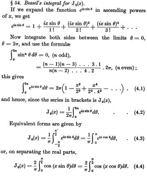

The problem is most books just make
[tex]J_n(x)=\frac{1}{2\pi}\int_0^{2\pi}e^{jx\sin\theta}d\theta=\frac{1}{\pi}\int_0^{\pi}e^{jx\sin\theta}d\theta=\frac{2}{\pi}\int_0^{\frac{\pi}{2}}e^{jx\sin\theta}d\theta[/tex]
That cannot be right!

Hm. I don't know where you've seen that, I've never seen such a relation, and it just seems to be incorrect (even assuming you mean to write [itex]J_0(x)[/itex] there). If you'd have [itex]\Re[/itex] in front of them, it'd be correct, as the real part of the integrals do indeed give the Bessel functions.
Based on your usage of j, I assume that the material you're reading is engineering-oriented. Is it possible that all these functions are meant to represent a physical quantity and there's a general convention that the real part of a function is always taken to represent the physical function or something like that, and the imaginary parts are just 'ignored'? It's often done with waves and such, and I guess one could do that in general as well, although it does strike me as an odd thing to do.

Attached is p57 of Introduction to Bessel Functions by Frank Bowman. Also it is in page 7 of this paper http://www.math.kau.se/mirevine/mf2bess.pdf
This is where I got stuck for days! Thanks for your help.
The paper seems to have a typo in it (the upper limit should be [itex]2\pi[/itex]), and the attachment has a cosine, not sine, in the exponent of eq. (4.3): It is indeed true that [itex]J_0(z)=\frac{1}{\pi}\int_0^\pi e^{iz\cos\theta} \mathrm{d}\theta[/itex], but earlier you wrote that the books said the zeroth Bessel function is [itex]\frac{1}{\pi}\int_0^\pi e^{iz\sin\theta} \mathrm{d}\theta[/itex] – just some carelessness, it seems. Eq. (4.4) also seems to be correct as it's written.
I am confused, you said [itex]J_0(z)=\frac{1}{\pi}\int_0^\pi e^{iz\cos\theta} \mathrm{d}\theta[/itex] is true? I wrote my reasoning in the other post that this cannot be true for interval [0,π]. Please explain.

Sorry, I mis read your post, I was looking at the interval of integration. Now I saw [itex]\frac{1}{\pi}\int_0^\pi e^{iz\cos\theta} \mathrm{d}\theta[/itex]...which is ##\cos(z\sin\theta)##. I never commented on this at all. Still stuck at the interval, never get to (4.3) and (4.4) yet.
So bottom line ONLY [itex]J_n(z)=\frac {1}{2\pi}\int_0^{2\pi}e^{jz\cos\theta}d\theta[/itex] is true, not [itex]J_n(z)=\frac {1}{\pi}\int_0^{\pi}e^{jz\cos\theta}d\theta[/itex]. This is all I want to know at this time.
