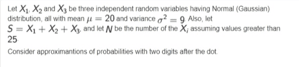

Let ##X_1 X_2 X_3 ## be three independent random variables having Normal(Gaussian ) distribution, all with mean ##\mu##=20 and variance ##\sigma^2##=9. Also let ##S=X_1+ X_2 +X_3## and let ##N## be the number of the ##X_i## assuming values greater than 25.

I agree with you but it was explicitly requested in the text, wasn't my choice. other way there would be no match with the possible answers.

In the following, the screenshot of the exam paper, logical or not logica, I did not write the exam.
