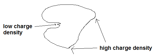

Every part of the surface is at the same potential. If the more curved parts are exposed, the situation is similar to the small sphere. If they are hidden somewhere in a notch, their charge density can be small.
Sorry I could not understand what you meant by "hidden somewhere in a notch". please elaborate a bit.
Like this:
Is this low charge density at the notch due to great repulsion from nearby charges (i suppose) Or is there some other reason ?
It is low due to the specific geometry here.
The electric potential is roughly the same everywhere in the notch (it is exactly the same everywhere at the surface!), which leads to low charge concentrations at the surface.
OK, So since the potential at every surface has to be the same and there is more surface nearer to a point in the notch so the charge density has to be less there in order to make the potential same as that of every point. Is that what you meant? (a rough approx. I mean)
The surface area has nothing to do with that, and there is no meaningful relation between potential (as absolute value) and charge density here.
The electric field is weaker, and surface charge density is proportional to the field at the surface.
