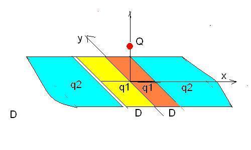

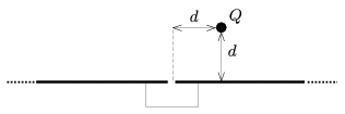

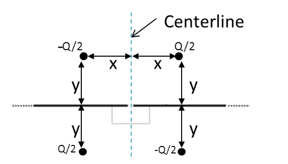

There are two big, same size, uncharged metal sheets in the same plane, lying parallel and very close to each other. The sheets are connected through a piece of wire, and then a pointlike charge Q is placed next to them as shown in the figure. What will the amount of charge on each metal sheet be?
I am not sure but is this related to method of images? But I doubt so because the metal sheet is not grounded. How to proceed then?
Any help is appreciated. Thanks!

Integration? Don't we simply place an image charge in method of images on the other side of conductor? :confused:
The image charge helps to find the field. So yes, that's good. You are being asked to find the charge distribution on the plates. Or rather: the integral thereof over each half-plane. Nudge nudge...

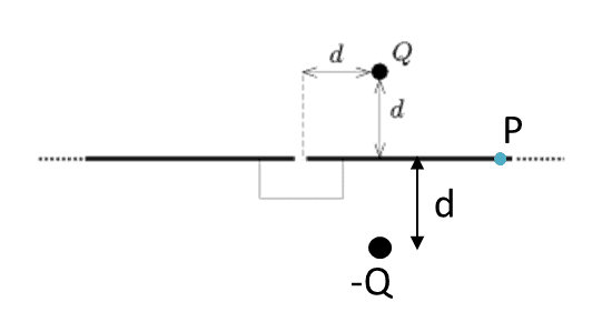

I am not sure if I understand that. Please see the attachment. Did I place the image charge correctly? If I find the the field at point P, I can find the "local" charge density at P but how do I set up the integral?

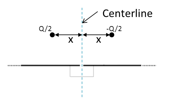

Suppose you had two identical charges of magnitude Q/2 placed symmetrically with respect to the centerline. What would the charges on the two plates be? Suppose you had two charges of magnitude -Q/2 and +Q/2 placed symmetrically. What would the charges on the two plates be?
I have indicated the centerline, do you mean that?
Do I have to place an image charge for -Q/2 and Q/2?

Pranav-Arora said:
Hi Chestermiller! :)I have indicated the centerline, do you mean that?
yes.
The figure has them reversed from the way I intended.

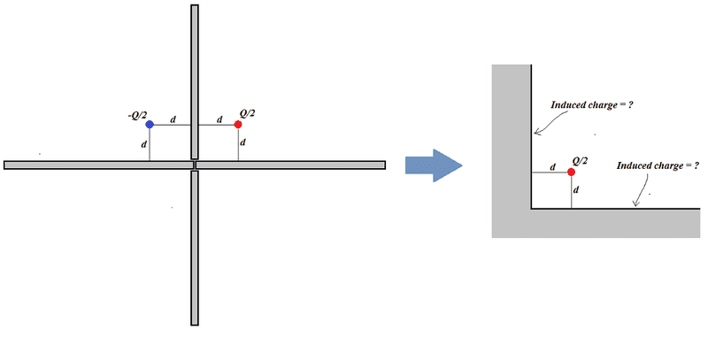

I have fixed the sketch but I still don't know how to proceed with the problem. Do I place the image charges as shown in the sketch?

Pranav-Arora said:
Sorry for the delay in reply. :redface:
No. Get rid of the ones below the plate. Just leave the ones above the plate. Now, in order to maintain charge neutrality relative to the centerline, what does the charge have to be on each of the plates (with a charge of -Q/2 above the left plate, and a charge of +Q/2 above the right plate)?
I am honestly lost here, isn't that specifically what the question asks? :confused:
The sum of charges on the two plates should be zero so each plate must have equal magnitude of charge but how do I find this magnitude?
If both charges were + Q/2, then, by symmetry, you would have no charge on either plate. If the left charge was -Q/2 and the right charge was +Q/2, then, by symmetry, charge would migrate through the wire until you had +Q/2 on the left plate and -Q/2 on the right plate. So by superposition, if you have a charge of +Q above the right plate and no charge above the left plate, the charges on the plates will be +Q/2 on the left plate and -Q/2 on the right plate.

Chestermiller's approach is very insightful and I think will lead to the right answer with a little more effort.
With the equal and opposite charges +Q/2 and -Q/2, each plate will become oppositely charged. But only if the two charges ##\pm##Q/2 are very far from the center line will the charges on the plates be ##\mp## Q/2.
With the charges +Q/2 and -Q/2 in place, suppose you consider an imaginary plane that lies perpendicular to the plates and contains the line separating the plates. What can you say about the potential at points on this plane?
Hi TSny! :smile:
The potential is zero at every point on this plane.
Yes, it would be an equipotential surface. Now imagine this imaginary vertical plane replaced by a conducting plate. Would that affect the charge induced on the original horizontal plates?

Think about a few simpler cases. Consider an equipotential surface between two infinite parallel plates of opposite charge. If you replaced that surface with a thin conducting sheet, would it affect the electric field outside the sheet or affect the charge distribution on the original plates? Note, though, that there would be surface charge induced on the sheet.
Suppose you had a charged conducting sphere. The equipotential surfaces outside the sphere would be spherical surfaces. If you replaced one of these equipotential surfaces with a thin conducting spherical shell, would it affect the electric field (outside the shell material) or affect the charge distribution on the original conducting sphere? Again, there would be surface charge induced on the inner and outer surfaces of the shell.
In general, if you have found an equipotential surface for an electrostatics problem, then you could replace that surface with a thin conductor and not affect the fields or charge distributions in the system. But, generally, there would be surface charge induced on the surfaces of the thin conductor.
No, in both the cases. So in the given case too, the charge distribution is not affected, right? But how does placing a thin conducting surface helps in this case? :confused:
Right. If you replace the equipotential surface by a conducting plate, then the charges on the original plates do not need to undergo any change in order to satisfy boundary conditions.

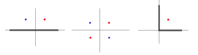

See if you can relate the diagrams shown.

So I guess I have to use method of images now?
But why did we replace the original charge +Q with +Q/2 or are you going to come at this later? :confused:
I don't think you need images now. Think Gauss' law.
We chose Q/2 to follow Chestermiller's superposition of the {+Q/2, +Q/2} scenario with the {-Q/2, +Q/2} scenario.

Do I select a cylinder as the gaussian surface? :confused:
think biiiiiiig :wink:
