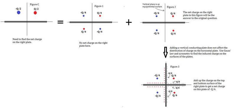

Try to construct a Gaussian surface that encloses the point charge and for which you know the value of E at every point on the surface.

Yes, we add a vertically conducting plate as shown in the third figure attached.
In the three figures shown, the electric field in the first quadrant is the same for each figure. In the figure on the left, the charge induced on the portion of the horizontal plate where x > 0 is the same as for the right figure.
Also, due to symmetry in the third figure, you can compare the charge on the vertical plate to the charge on the horizontal plate.
Using Gauss' law you can determine the total charge induced on both the horizontal and vertical plates in the third figure. [EDIT: Note that you can choose parts of the Gaussian surface to lie in the xy horizontal plane and the yz vertical plane where it may be considered to be inside conducting material.]

Thanks TSny. I've finally gotten the idea of how to do it. But I would have set it up a little differently than you have done it. With reference to your figures, in the first figure, our starting point is with the charges equal to -Q/2 and + Q/2. I would then have represented this figure as the sum of two other figures: (figure 1). Your middle figure with Q/4 s, and the signs on the charges the same as in your figure, plus (figure 2). Your middle figure with Q/4 s, but with both positive charges on the right and both negative charges on the left.
Because of symmetry, the setup in (figure 1) would not give rise to any net induced charges on the two plates. But, the setup in (figure 2) would give rise to the same total induced charges on the plates as in the original problem. Also, in (figure 2), the charges on the upper and lower surfaces of each plate would be identical, and the electric fields within the plates would be zero. I would then place a vertical plate on the same vertical zero-potential surface that you have used in your third figure. This plate would develop an induced negative charge on its right surface and an induced positive charge on its left surface. The electric field within this plate would be zero, and the charge distribution on the right side of the plate would be identical to the charge distribution on the upper surface of our right plate. This would represent my third figure. I would put one Gaussian planar surface down the middle of the right plate, another Gaussian planar surface up the middle of the vertical plate, and a third Gaussian surface at infinity. So, my third figure would look essentially identical to yours. But the point charge would be +Q/4, only half the charge on the right plate would be included within the Gaussian surface, and only the negative charge on the vertical plate would be included (and this would equal the charge on the upper surface of the right plate). If q was half the charge on the negative plate, then by applying Gauss's law, q = -Q/8. So, the full charge on the right plate would be -Q/4.
I hope this makes some kind of sense. It was very hard to describe in words. If you were able to understand my description, does this work for you?
Chet

Chet, I'm pretty sure I followed your logic and it looks correct to me. Nice!

I've made an attempt to summarize Chestermiller's "no integration" method with a couple of pictures. Any errors are my own.
The method is to replace the original problem with a superposition of other problems that are easier to analyze but still produce the same net charge on the right half of the horizontal plate.
The first picture attached shows the original problem as Figure A. This figure is thought of as a superposition of Figure B and Figure C. Since Figure B does not contribute any net charge to the right plate, we can just consider Figure C. Note that the distribution of the net charge on the right plate in Figure C is not the same as the distribution in Figure A. But, that's OK since we are only interested in the net charge on the right plate, and the net charge on the right plate is the same in Figures A and C. (The distribution of charge in Figure A is the superposition of the distributions in Figures B and C.)
In the second picture attached, Figure C is replaced by a superposition of Figure 1 and Figure 2. Figure 1 provides no net charge on the right plate. So, the net charge on the right plate in Figure 2 is the same as the net charge on the right plate in Figure C which is the same as the net charge on the right plate of the original problem (Figure A).
A vertical conducting plate is added to Figure 2 to get Figure 3. This additional plate does not disturb the charge distribution on the horizontal plate. Then, using Gauss' law and symmetry you can deduce the surface charge on the plates in Figure 3 and arrive at the final answer.
  • Three-panel diagram: Figure A shows a red charge Q above a horizontal plate split by a vertical line into left and right plates; Figure B shows two red charges Q/2 above the left and right plates; Figure C shows a blue charge -Q/2 above the left plate and a red charge Q/2 above the right plate.
Ok, this is going to be silly, why no charges are induced in the case of figure 1? :confused:
I still don't get the point of adding the conducting plate and why it doesn't affect the given setup. Is it not possible to find the induced charges directly without the conducting plate? Why does adding the conducting plate allows one to use these symmetrical arguments to reach the answer? :confused:
It is ingenious! Thank you TSny.
Charges are induced on the top surfaces of both plates, but they are equal because of symmetry, just like the opposite charge on the back surfaces. So the net charge of both plates is zero.
Is this method illustrated in any book? I have both Purcell and Griffiths, is this method present in any of the two books?
An equipotential surface and a metal surface are alike as the potential is the same and the electric field lines are normal to both. You get the same electric field of the four charges in each quadrant without the vertical plate and with it. In the latter case, when determining the field in one quadrant, the mirror charges are the same at the same places as the real ones.
