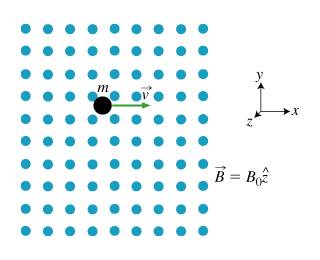

The particle moves in a plane perpendicular to the magnetic field direction as shown in the figure. What is omega, the angular frequency of the circular motion?
Express omega in terms of q, m, and B_0.
omega=2pi/T
I found that At a given moment the particle is moving in the +x direction (and the magnetic field is always in the +z direction). If q is positive, the direction of the force on the particle due to the magnetic field is -y direction
The force on a charged particle in a Magnetic Field B is given by F = q(v X B).
The force required to accelerate a particle of velocity v in a circular motion is related to the radius of the circular path and the mass of the particle by F=(m*v^2)/r
Omega can also be expressed as v/r.
By equating the two forces and playing around a bit I'm sure you'll come out with your answer.
can anyone give the Lagrange of the system in plane polar coordinates?
