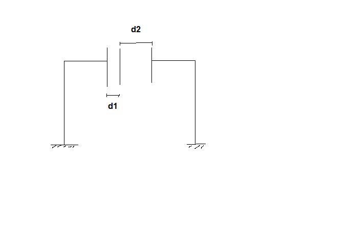

3 metallic plates are placed at a separation d1 and d2 as shown in figure. A charge Q is given to the middle plate which is free to move, then
A)it will slide towards left if d2>d1
B)it will slide towards right if d2>d1
I found out the charge distributions on the the first and last plate as -Qd2/d1+d2 and -Qd1/d1+d2 resp.
Now to calculate the force on the middle plate due to one plate (say first), shall I take the charge on the middle plate as Q or Qd2/d1+d2 ?

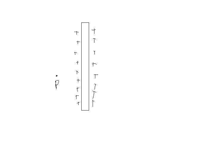

Refer this:
(I lost my patience while drawing + signs :biggrin:)
The electric field at point P is due to the left and right side of the charged plate.

It is a metal plate, Q charge on both sides. When the area of the plate A is big the electric field is homogeneous near the plate and far from the edge at both sides. Apply Gauss' law. 2A*E=2Q/ε: The electric field strength is Q/(Aε) that is, the surface charge density/ε.
In terms of electric field lines, the electric field strength is the number of field lines crossing perpendicularly an unit area. For an isolated point charge Q, the number of field lines crossing the surface of a sphere of radius R is
Q/(4πεR2) * (4πR2) = Q/ε,
that is Q/ε field lines emerge from a positive point charge of magnitude Q. In case of a surface charge on a metal plate, all the field lines point outwards so E=Q/(Aε).
In your case tha surface charge density is different at the sides of the metal plate so the electric fields are different to. You can imagine the three plates as two different capacitors connected to the same potential.
ehild

Have you learned about capacitors?
Assuming that they can thought of as parallel plate capacitors with the same plate area, A, C1=Aε0/d1 and C2=Aε0/d2.
Both capacitors are grounded on one side. The potential difference across each capacitor is the same.
V=\frac{Q_1}{C_1}\ \text{ and }\ V=\frac{Q_2}{C_2}\,,\text{ where }Q_1+Q_2=Q
That should allow you to compare the charge on each side of the common metal plate, and thus compare the electric field on each side.

E1=V/d1 & E2=V/d2
Yes that comes out using formulae.

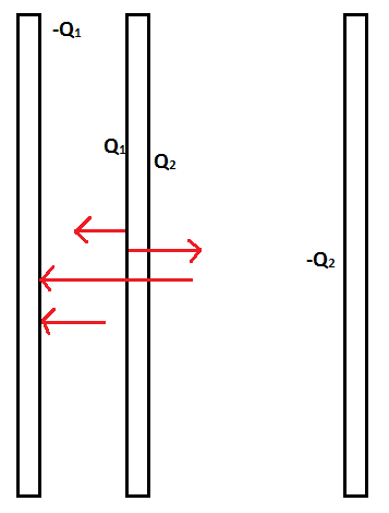

But I am thinking about the problem another way. Why is the electric field between the first two plates only due to the charge on the middle plate on one side and not due to the other side? The electric field due to the charges on the other side cannot be shielded by a metallic plate (Why? - refer post #17)
Look at the pic
i have shown only for +-Q1 ... the field outside the region b/w them has no field as their fields gets canceled as shown in fig.
hence there will be no force on Q2 due to -Q1

@cupid.callin
I don't understand your figure totally but one comment-
Q1 and Q2 are different...the field does not get cancelled.
the fields i have shown are only due to -Q1 n Q1
if Q2 was supposed to cancel the field then that means that there is field at position of Q2 ... then why there would be a question ... the fields of "" ---Q1 and -Q1 --- "" at position of Q2 are canceled ... that's why q2 experience no force
I have no idea what you are talking about. (btw your figure is deceptive- there is no field line inside a plate!)
