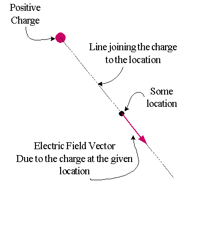

The fields due to each charge are independent and simply add at any given point... the total field is given by the sum of the contributions due to the individual charges taken one at a time. In this sense, then, charges do not interfere with each other. The fact that like charges repel does not in any way change the fields that those charges individually produce at a given location.
The direction of the field produced at a given location is directed along a line joining the (point) charge to that location. The field will be directed in the opposite direction of the charge if the charge is positive, and towards the charge if it is negative.
I'm not sure why you keep referring to "pointing inside" or "pointing outside". The vectors you're looking for are not attached to the charges themselves. You are looking for the field vectors at the center point of the triangle: The origin of those vectors are "attached" to that point and will be directed either to or way from the associated charge causing that field.
