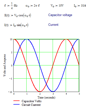

Make that "rate of increase". The current will follow a sine curve, starting at zero and heading towards a maximum. If you look at a sine curve you can tell the "rate of increase" by the slope of the curve as time progresses.
EDIT: You can get all of this graphically if you'd plot the capacitor voltage and circuit current on the same graph. Math can be visualized through graphs.

  • #42
Here's another graphical summary of what is going on. It doesn't include the fancy energy curves that @anorlunda 's plot had, but hey, apparently I'm far more lazy than he is :smile:
Done with Mathcad: (See: lazy!)
