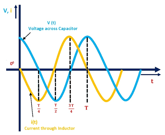

The energy in the tank circulates back and forth between the current stored in the inductor and the voltage across the capacitor. When one is max, the other is zero. The phase difference between ##v(t)## and ##i(t)## is 90 degrees, due to the interrelationship of the two differential equations.

$$ V_C = V_L = L \frac{dI}{dt} $$
The rate of inductor current change is proportional to the capacitor voltage. At ##t=0## the capacitor voltage is at it's maximum value, so is the rate of change of the inductor current. Then the inductor current flowing through the capacitor causes its voltage to decease (the other equation).
That is just how inductors work, you can't instantly create the magnetic field that results from current flowing, you have to "charge" it up. In the same way that you can't instantly change the voltage of a capacitor.
