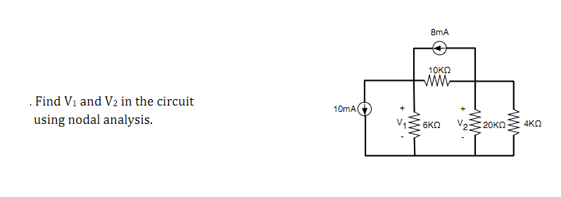

Checking signs in nodal analysis circuit problem
naivy
40
Circuit schematic with two node voltages V1 and V2 marked, resistors 6KΩ, 10KΩ, 20KΩ and 4KΩ, current sources 10mA and 8mA, with a note to find V1 and V2 using nodal analysis.
Nodal Analysis, KVL
Your nodal equations are correct.

Thanks dude.
I think I'll check out Derive, but probably for the pset after this one. I'd rather work on this pset now rather than learn how to use Derive.
If you do get Derive, if you let me know I can show you in a minute how to solve simultaneous equations like the ones you have here. Especially if it's the old DOS version. Get that one if you can, it should come with a hardcopy user manual.
