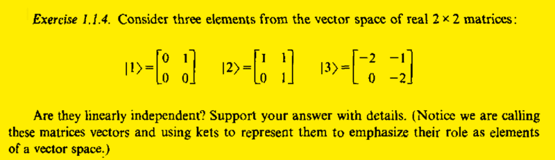

3. The Attempt at a Solution [/B]
## |3 \rangle = |1 \rangle - 2 ~ |2 \rangle ##
So, they are not linearly independent.
One way to find the coefficients is :
## |3 \rangle = a~ |1 \rangle +b~ |2 \rangle ## ...(1)
And solve (1) to get the values of a and b.
Is there any other easier way?

It doesn't get much easier than that. Since ##a## and ##b## are overdetermined, you can choose two elements from each matrix (the right column from each, for example) and solve the reduced problem
##\begin{bmatrix} 1 & 1\\0 & 1 \end{bmatrix} \begin{bmatrix} a\\b \end{bmatrix} = \begin{bmatrix} -1\\-2 \end{bmatrix}##
and then check the resulting ##a## and ##b## on the left columns.

I think you have done things the easiest way -- by inspection.
Another way is to use the definition of linear independence. The matrices A, B, and C (which you are calling |1>, |2>, and |3>) are linearly independent if there is only the nontrivial solution for the constants in the equation ##c_1A + c_2B + c_3C = 0##. By nontrivial, I mean solutions other than ##c_1 = c_2 = c_3 = 0##.

I did not understand what you meant by "##a## and ##b## are overdetermined". When to use this concept in general?
An overdetermined problem is one in which you have more equations than variables. In this particular case you have four linear equations to solve for two variables.
##0a+b=-2\\a+b=-1\\0a+0b=0\\0a+b=-2##
or
##\begin{bmatrix}0 &1\\1&1\\0&0\\0&1\end{bmatrix} \begin{bmatrix}a\\b\end {bmatrix}= \begin{bmatrix}-2\\-1\\0\\-2\end{bmatrix}##
In general such a system of equations can have no solutions, one solution, or an infinite number of solutions. There are no solutions if and only if the vectors are independent. You can use Gauss-Seidel to determine this. Or you can try to find a set of linearly independent rows (easy in this case) in the leftmost matrix, remove the other rows (on both sides), and solve the reduced problem.

It is pretty easy in this case. The first equation says that ##0 a + b = -2##, so ##b = -2.## The second equation says that ##a+b = - 1\: \Rightarrow a = -1 - b = -1 + 2 = 1.## Now check if these values of ##a## and ##b## satisfy the third and fourth equations.
