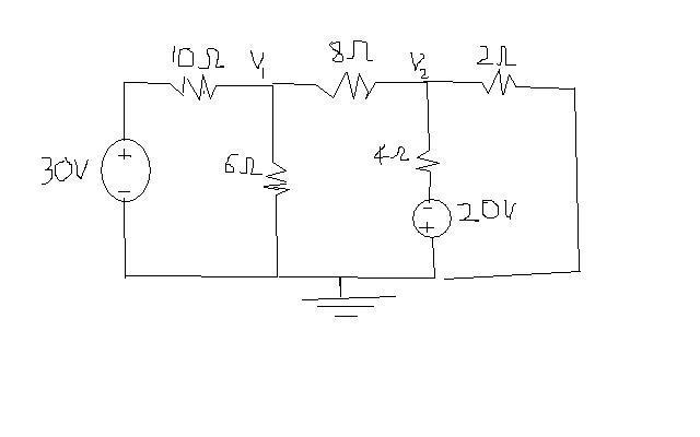

The question is as follows:
Start with KCL for the nodes and write the node voltage equations for the nodes V1 and v2 in the circuit (diagram is attached to this post). They do not want me to solve the equations but just simplify to gather the coefficents.
KCL
I marked node one where v1 is. So for node 1 it would be (v1- 30)/10 + (v1-v2)/8 + v1/6=0
I marked node 2 where v2 is. So for node 2 it would be (v2- v1)/8 + (v2+20)/4=0
Still, I am not that sure about my node 2 equations although my node 1 may be correct. Please help! THanks!
  • Circuit schematic with a 30 V source and 10 Ω resistor feeding node V1, with a 6 Ω resistor from V1 to ground; V1 connects through 8 Ω to node V2, which has a 4 Ω resistor in series with a 20 V source to ground, and a 2 Ω resistor to the ground rail.

node 2 is wrong, you forgot 2 Ohms resistor.
Can u please elaborate and write down the node 2 equation. Thanks
what would be the thing for the 2 ohm resistor then?
(v2- v1)/8 + (v2+20)/4 + v2/2 =0
