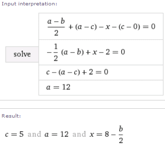

Essentially I am having trouble with solving for I_sc when I remove the load and replace it with a wire.
I used a super node at 1 and 4 and also in my diagram I have defined the currents with directional arrows. I have been on this question for a long time and cannot get the correct answer which is I_sc = 8mA. I know it is wrong because I plugged it into wolfram alpha and ended up with the results as seen below.
From KCL:
Where V1=a, V2=b, V3=c, I_sc=x and solving it gets:
V2 = 0, because node 2 is shorted to ground.
