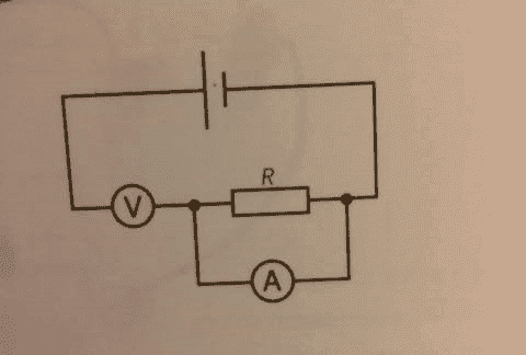

Why does my book say this is wrong?
Think about the resistances of the measuring instruments for the corrisponding values you want to determine.
What should be the resistance of a Voltmeter to obtain the correct voltage?
What should be the resistance of an Amperemeter to obtain the correct current?
the current is probably going to be low because the volt meter has a high resistance. But why is it incorrect?
my book: it is wrong to have an amp meter parallell because its resistance is so low that the amp meter could burn (too much current flowing through it). But how can the currrent be high if the volt meter has a high resistance?

If the right Voltmeter and settings respectively is used the current should be zero. What would you measure, if there is no current?
And what about the resistance of the Amperemeter?
okay now I know what you mean but my book is saying that the amp meter is going to burn and that's the part i don't get
That's true, if you put the Voltmeter in this position the Amperemeter wouldn't burn, but there is also no current, so the Amperemeter is useless. If you put away the Voltmeter and have the Amperemeter connected in parallel you would create a short circuit. A Voltmeter is always connected in parallel and the Amperemeter in series. I think the task is to measure the difference of voltage at the resistor and the current passing it, which can be realized by changing the position of the instruments.
what happens if we switch places with V and A? So the amp meter is in series and the V meter is in parallell? now the amp meter is going to burn right? because the current is too high

Common errors while connecting measuring instruments are placing parallel ammeter and voltmeter in series. placing the voltmeter in series cause no harm. because its resistance is so great will power to the circuit to be nearly zero. To place ammeter in parallel is a serious fault. because its resistance is so small it will go much current through it and ammeter may occasionally burn out .
Its possible the book is wrong. My guess is they attempted to show two errors on one diagram and failed to notice that one error interacts with the other. The amp meter would burn if the volt meter wasn't also in the wrong place.

We, or should say I say I, have determined that the translation you posted was NOT in reference to the circuit you first posted.
As was correctly mentioned;
The volt meter acts as an "open" in the circuit, so no voltage is seen across the resistor.

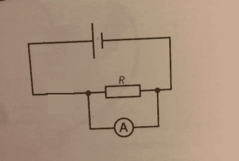

Here is the circuit your book was referring to:
The ammeter will burn.
Please explain why.

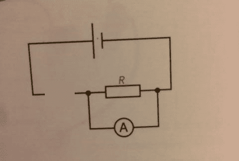

...and not burn
As inferred by CWatters:
How are you going to get any current, anywhere, when the wire is broken?
oh now i get it. the books picture confused me :p thanks for explaining!
