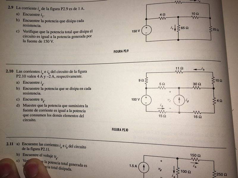

4. Translation
The currents I_a and I_b of the circuit have values 4A and -2A in that respective order.
A) Find I_g
B) Find the power dissipated by each resistance
C) Find V_g
D) Show that the power delivered by the current source is equal to that dissipated by every other circuit element.
