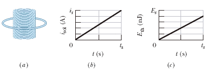

In Figure (a), a circular loop of wire is concentric with a solenoid and lies in a plane perpendicular to the solenoid's central axis.The loop has radius 6.13 cm. The solenoid has radius 2.07 cm, consists of 8230 turns/m, and has a current i_sol varying with time t as given in Figure (b), where the vertical axis scale is set by i_s = 1.03 A and the horizontal axis scale is set by ts = 4.6 s. Figure (c) shows, as a function of time, the energy E that is transferred to thermal energy of the loop; the vertical axis scale is set by Es = 101.6 nJ. What is the loop's resistance?
I want to find B, the magnetic flux density such that I can work out what the EMF is.
From the EMF I can use
$$ P = \frac{EMF^2}{R} $$
To work out R as I know what P is since that is J/s.
However how can I find B when:
$$ B = \frac{\mu N I}{2R}$$
and I don't know what the current (I) is? As the current varies over time.If someone could provide what is going on in terms of the physics and the required next steps that would be great!

Look carefully at figures (b) and c. From (b) you can determine completely the function I(t) (that is the current as a function of time t) and from (c) you can determine completely the function E(t).
Sorry I don't follow, I can find the rate of change of these with regards to time, however I don't see anything I can do it with
How can you find the rate of change of I and E w.r.t to time t?
And of course you can do many things with it, from the rate of change of current(which will be the same (up to some multiplicative constants) to rate of change of magnetic field B of the solenoid) and Faraday's law of induction you can calculate the EMF through the circular wire loop. From the rate of change of energy you can calculate the Power, due to the EMF and current, that is dissipate as heat in the resistance R of the loop.

Two-panel figure: (a) a circular loop concentric with a solenoid in the same plane, with current i_sol shown; (b) a graph of solenoid current i_sol against time t; (c) a graph of energy E_th transferred to thermal energy in the loop against time t.
Judging by this, A = pi * 0.0207^2 (Solenoids radius right?) And n (Not N) = 8230/m
Well you are correct for A (and for n). But tell me why you chose A to be the cross section area of the solenoid and not the cross section area of the wire loop
And also tell me what is N
